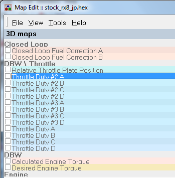

Well I finally have it properly registered and have a map I can edit :-) Will see what I can do with it tomorrow. Right now my head is spinning just looking at all the tables. The first thing I was going to try was editing the throttle map. I think I have the right table, it is labelled "throttle duty", the only problem is that there are 12 of them! I guess 3 to cover the different gears ( <no number>, #2, #3), and then 4 of each of those to cover ??? (A, B, C, D)
What are the chances I edit one, and it changes something completely different?
no idea why so many maps - suspect one set actually does the business and the other two do nothing . The throttle maps actually take quite a bit of sussing out to get the results you want . Dunno if that is such a good place to start.
Start simple with fan on temps / idle speed etc

4. Turn ignition on
5. Plug in the openport to the usb port
6. Start mazdaEdit, start the flash utility (F11)
7. Hit the read information about ECU icon (F3)
8. Open the ECU rom image using the file open icon
9. Hit the write icon (F9)
10. Don't move or touch anything while it uploads the data.
With my part-written flash, step 7 was not able to read any information from the ecu, but I was still able to write the data successfully.
I'm sure there are other combinations that work, but there are also some that don't!
About 5 steps too many but ................... do whatever works

After all that fun, I have now made successfully made some small changes on my s2 and I also figured out the issue with logging sample rates (selecting certain fields that did not return any values dropped the achievable sample rate significantly)
