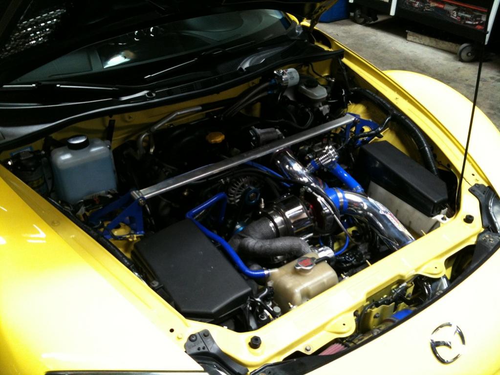

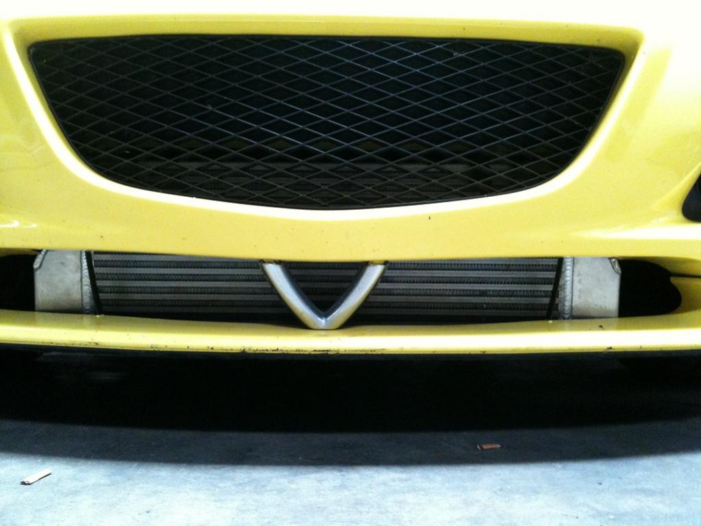

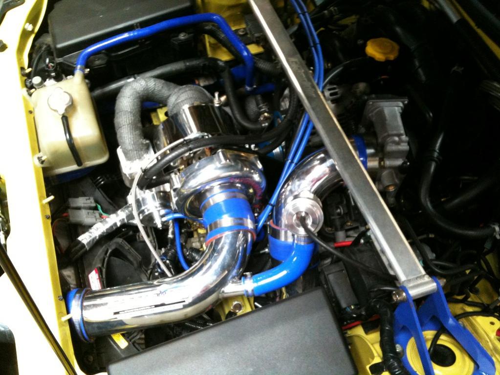

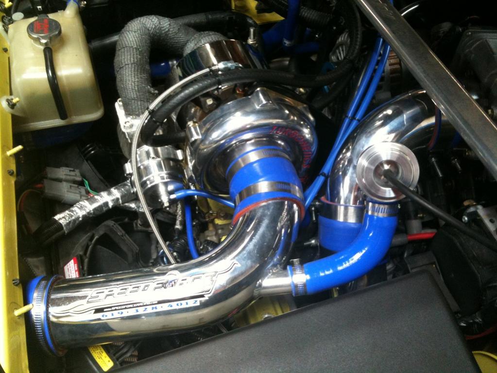

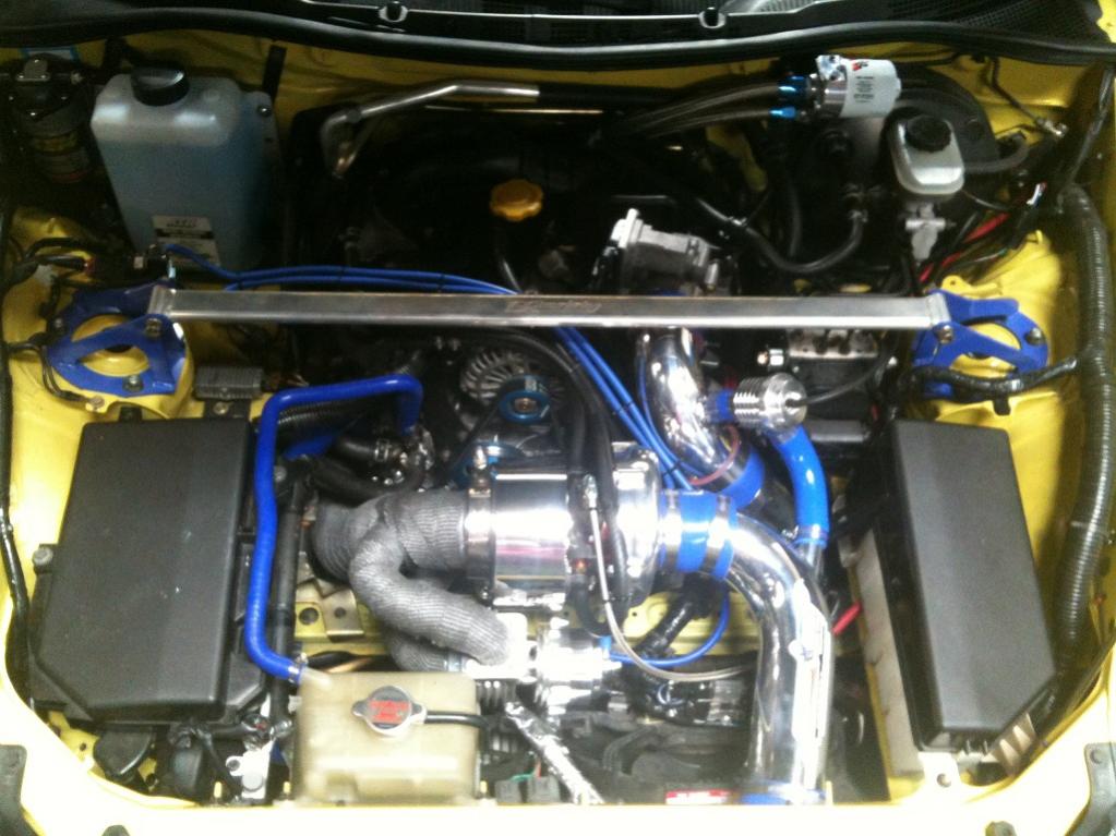

Yes actually
Just got back from SFR today; we were not able to get a tune put on the car because we wanted to wait for Jeff (MazdaManiac) to be able to come down and do the tune himself as this is uncharted territory. But the good news is the car runs! Here are a few pics to drool over and a short video.
[EMBED]<object width="425" height="344"><param name="movie" value="http://www.youtube.com/v/NRBkcPH6w-w&hl=en&fs=1"></param><param name="allowFullScreen" value="true"></param><param name="allowscriptaccess" value="always"></param><embed src="http://www.youtube.com/v/NRBkcPH6w-w&hl=en&fs=1" type="application/x-shockwave-flash" allowscriptaccess="always" allowfullscreen="true" width="425" height="344"></embed></object>[/EMBED]

Old Apr 25, 2010 | 01:26 PM
  #120
blackmagic8's Avatar
Posts: 15
Looking good.

From: So.Cal
Looking really good Wanted...do you have a picture of where your maf is mounted?

From: Layton, Utah
If you look in the second picture you can see the housing just after the filter.

I would like to but after looking at how much room I have down there I'm not sure it will be possible. I’m looking to get Jeff out there Wednesday, sooo Wednesday.
Originally Posted by Derex'8
Looking good Wanted2..heh you beat me to it just dropped my car off last week @ a local shop...and along w/a slew of other thing I'm getting my turbo setup reconfig'd......I'm having the 12" MAF housing moved to the upper part of the front bumper...How's the clearance for the MAF? If you can you should remove the rad panels and take a couple of shots?
Clearance is fine, the problem is length. The best picture I have is this one and the "rad panels" aka the air division panel is already removed.
