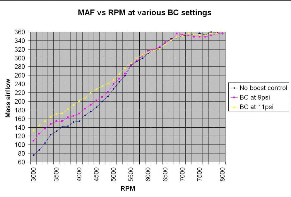

What this mod does is induce boost creep IE wastegate is unable to expel the exhaust gases fast enough and boost will actually climb as rpms climb without even having a boost controller.
You cannot reduce the boost from this level without re-adjusting the arm . If you want more boost lower in the rev range use your boost controller . But my advice is don't even bother with the boost controller because you will really like the way it drives when this is done- very precise throttle control and high boost where you want it - in the higher rev range .
This is the result I got with my upgraded Greddy and NO boost controller after doing this mod :
8psi up till 5000
9psi at 5500
10psi at 6000
Then tapering back down to 8.5psi at redline .
Example of how this mod effect mass airflow at various boost control settings - note that above 5500 boost is identical no matter what setting the BC is on indicating that above 5500 the BC is doing nothing .

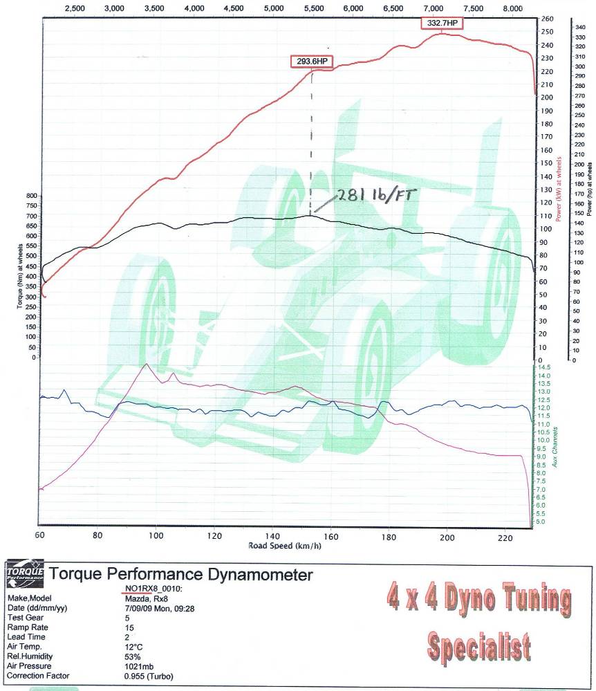

The Greddy intercooler starts to become a restriction to flow at around 260g/s which is only about 5500rpm at 10spi .
If running the stock Greddy turbo this intercooler is fine but anything bigger than that making over 300whp would benefit from a larger intercooler.
I have run mine up to 350g/s (333whp) .

I made over 270 whp on my greddy without pushing anything. Not sure why you'd list 260 as max reliable.
Old Sep 13, 2009 | 04:32 PM
Brettus's Avatar
Boosted Kiwi
Posts: 20,844
Likes: 1,798
From: Y-cat-o NZ
well done . Most people struggle to get much over 250 .
