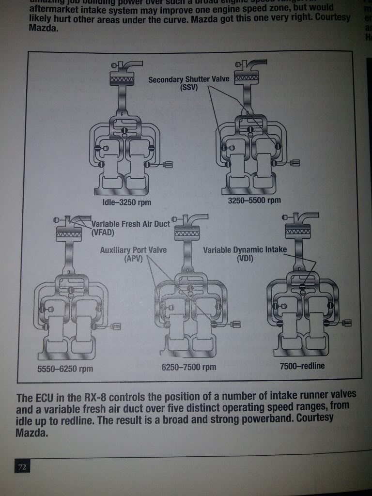

Well
I don't think your VDI is causing slow acceleration or causing it to run rough.
You've likely got other issues as well.
The VDI doesn't engage until 7250 rpm (normally closed, opens at 7200rpm)
All it is basically is a valve to allow dynamic super charging.
VDI = Variable Dynamic Intake
