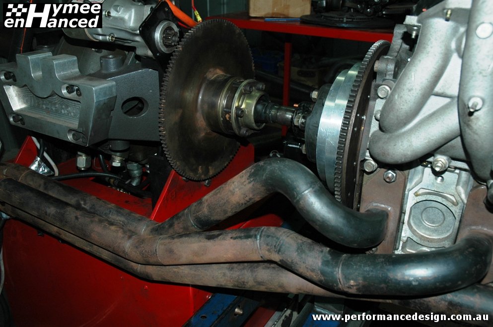

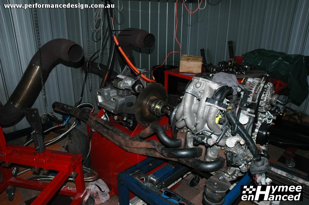

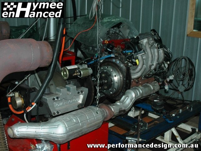

Hi all,
As part of our on going development of the RX-8's "Renesis" 13B engine, we are undertaking testing of the engine on a professional Engine Dyno cell.
Today, after some extensive work in making a stand for the Renesis (that can also accomodate 20B and 26B engines) I did a trial fit of the engine to the dyno facility.
Here are some pics of the engine set up and connected to the drive shaft of the dyno.
Actual testing to be carried out soon. Testing will be for exhaust studies as well as supercharger kit development.
I wonder what odds I can get for 177kW with a "stock" 6-port Renesis.
Cheers,
Hymee.
ID:	75235   Click image for larger version

No whoa's from me. Who said I was playing coy? Don't anyone believe for one second that I was the first person ("originally") to dispute the factory quoted figuers. No way, -ve Ghostrider.
I've said long, long ago, based on my very own chassis dyno tests, and a few rules of thumb, that the quoted figures might in fact be correct, and/or at least in the ball park.
What I am saying above, is that even if I do obtain "XXX" HP or kW at the flywheel, how much water does that hold in a lawsuite? Is there a national (internationally) accredited testing laboratory that will provde expert witness that my figures are correct, and that the manufacturers figures are false? Yes - we do have a national testing laboratory company in Australia (NATA www.nata.com.au), but I know of no NATA acreddited engine dyno facilities, and a quick search of that site does not reveal anything related to the measurement of engine power. Even a search on dynamometer only returns results related to load cell tensile testing of reinforced concrete structures. (Yes, I have Civil Engineering qualifications, so I know what that means )
What I will be using the initial results for, is a baseline for our own development. That is what a dyno is used for.
So I ain't going to hold back. I have go, now whoa. WOT for me, or dare I say "full steam ahead". LOL!
