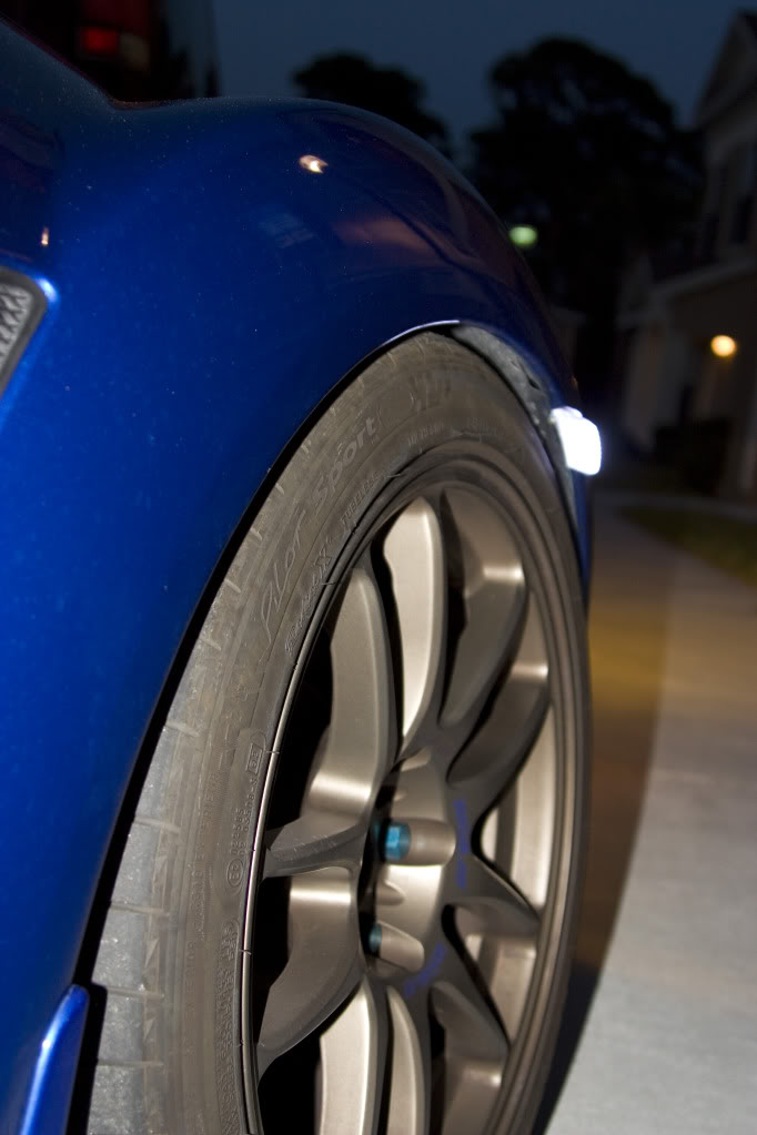

ok... so i took tilt's advice and drove one wheel up a driveway... and guess what... THA DA!~

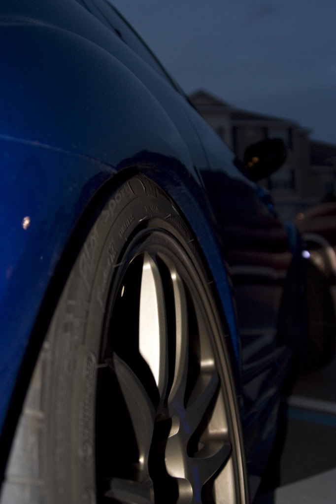

You guys can see how it rubs the tires... and... idk why for some reason... the fender's ripped outward?!

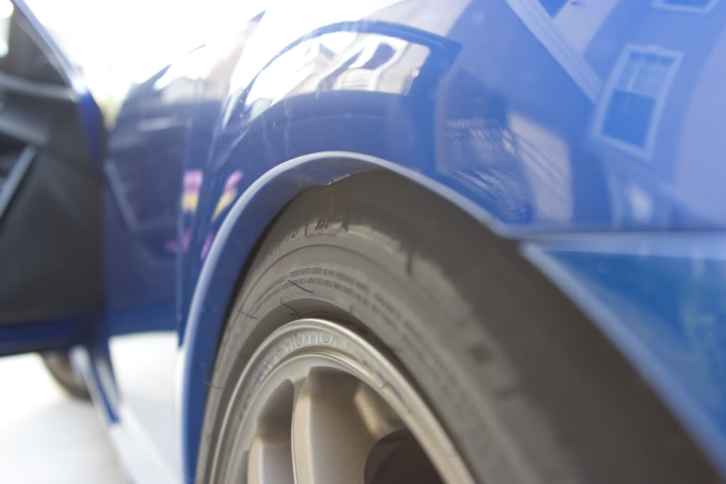

Originally....
For some reason the right wheel isn't rubbed as much, they are lowered on the same height (presumably, i'm lowered on HKS RS coilovers and my mechanics measured the ride height after installing them), and of same camber of -1.0

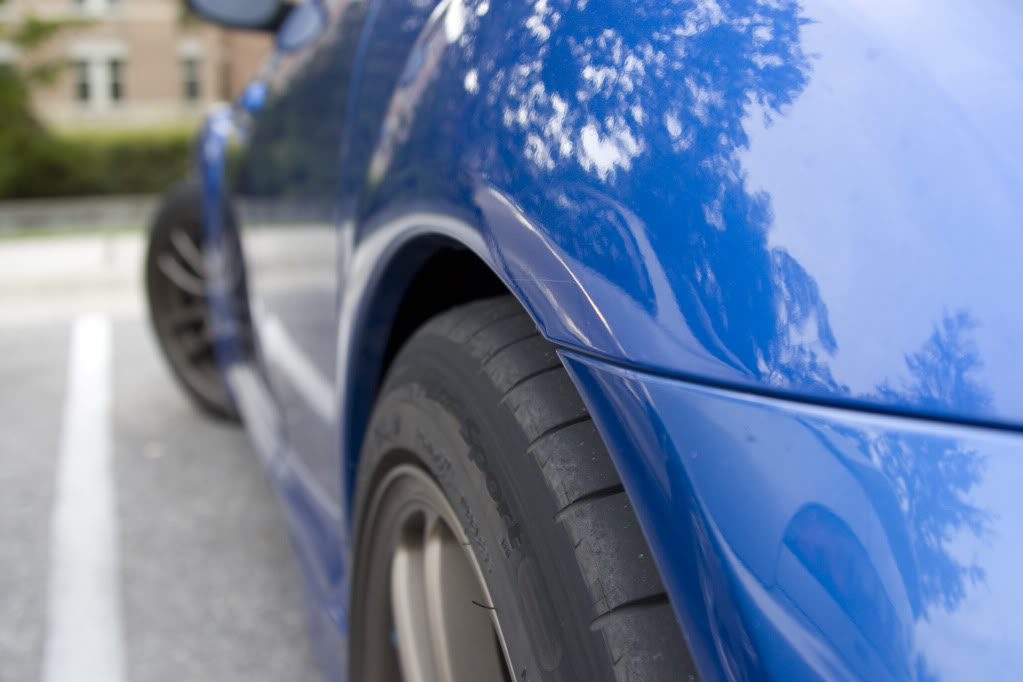

Now thing is... fronts are lower than the rear, but they are on -1.1 camber, and there's no rubbing whatsoever, the wheels clear the fenders pretty well.
So my question is... shud i roll my rear fenders? or shud i get it realigned and put -1.1/-1.2 camber on the rears?

Roll the fenders lol; it's a very easy fix.
The front fenders are different from the rear fenders (obviously) so it takes a little more to rub in front

You need a good roll and you will be fine....
