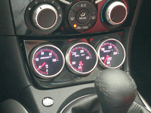

all the gauge pods are the same....you will always see a tad bit of the sides of the gauges...but thats ONLY if you look at it from the side..ie when the gauges are mounted in the pod before you actually install it in the car...
I was slightly worried about that...read that some people put black tape or marker around the sides of the gauges...but when i installed them it was a non issue...
im running the autometer cobalt series gauges with a water temp, A/F wideband and boost/vac...

Old Aug 27, 2007 | 04:13 PM
  #344
shinka213's Avatar
Pettit fangurl <3
Joined: Mar 2005
Posts: 5,386
From: Aston, PA
autometer cobalt series at nite
hey Jedi..
this is the best pic i have so far...without a tripod...
i just bought a tripod the other day to get some night shots...
prolly i'll post some up this weekend..

shinks: those look pretty bright! How are they driving at night?
Hey Jedi:
pic doesnt really do them justice...the camera is using a really slow shutter speed
to make up for the lack of light...consequently they look really bright....
to me, the lightning is just right...not too bright not too dark..
