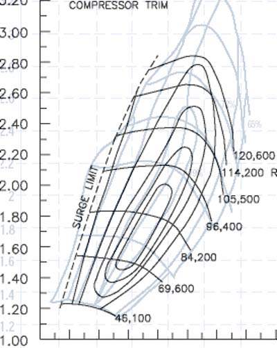

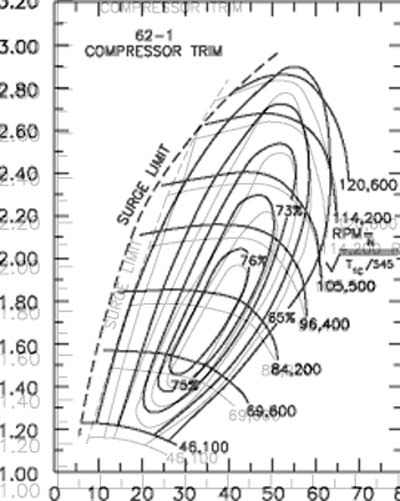

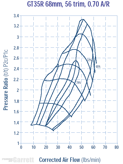

Originally Posted by Fanman
What's interesting is that some of people on the 350Z board who are looking at the single turbo Turbonetics kit (comes with 60-1) but are already inquiring about the 62-1 (supposedly flows 10% more).
and the 62-1 has now been discontinued...god knows why...it was a great seller.
anyhoo, it's been replaced with the gt37 wheel. it flows a bit more than the 60-1.
here are the 60-1, 62-1, and 35r compressors.
Attached Thumbnails t60-1 vs. GT35R-60-1-compressor-map.gif   t60-1 vs. GT35R-62-1-map.gif   t60-1 vs. GT35R-gt35r-compressor-map.gif

Old Jul 31, 2005 | 12:56 AM
guitarjunkie28's Avatar
port hacker
Joined: Nov 2004
Posts: 1,275
From: socal
and just for fun...
first one is a 60/62 overlay and the second is the 35r/60 overlay.
you can see how the 35 is capable of a lot more boost pressure efficiently. it ultimately has more power potential, but you do have to crank it up past 20psi to get it. at say 12psi, you'd probably never notice the difference between the 60-1 and the 35, but the 35 keeps going after the 60 quits.

if you look at the peak efficiencies, the 35 is very well suited to the older 13b's. stock or streetports do very well with them (76-79% efficiency). i don't know how it's going to like the renesis--maybe a 30/35 or 37...something a wee bit smaller might work a hair better.
