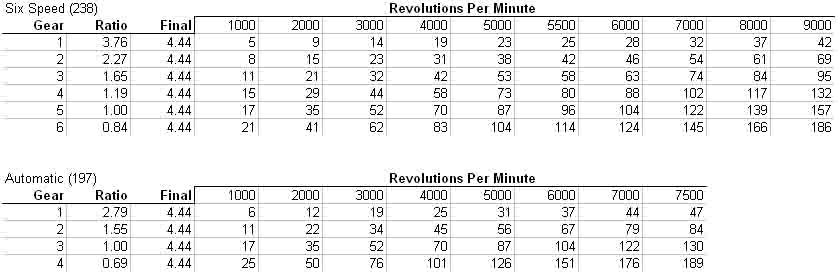

Based on this attachment, which may not be entirely accurate as it is theoretical rpm vs mph, at 83mph your at 4000 rpm stock and just above 4300 with the 4.778 gear. Regardless, take your cruising rpm and multiply it by 1.076 and you'll have your new rpm.

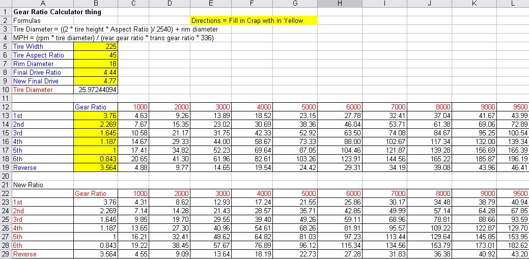

Here are the old vs new mph vs rpm. Looks like you would probably get same or better mph below 55mph.
QBallz is offline   Reply With Quote

I dont understand those figures for the current ratio. 132 in 4th gear is unattainable for our current setup. From my experience.. 4th at 9000 rpm is 120. 132 isnt correct.

those r simply theoretical rpm vs mph, theres drivetrain loss and air resistance involved in reality, but its a good comparsion of how ur rpm would change when u change out the final drive

^The only way those numbers are wrong is if the Formula's are wrong. There should be no drivetrain/air resistance factored into that unless you clutch is slipping.
