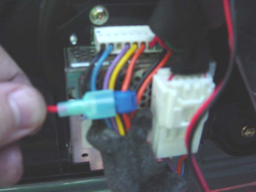

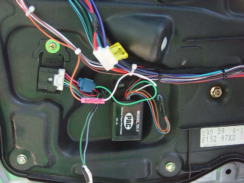

So I used Lurch's DIY for Auto Up/Down windows, but a added a little twist for those of us who don't have aftermarket alarms.
Follow Lurch's DIY here
http://www.rx8club.com/showthread.php?p=1563661
Then to make it work with just factory i used the PAC-audio TR-7. This device is a programmable trigger module. I set it up to take a double pulse input and output a steady signal for 5 secs. It has seperate wires for + and - inputs and outputs so it doesn't matter what type of signal you feed it or what it will output. So i used the Factory door lock pulse signal that goes to the door lock actuator. This is a Red/Blue wire in the connector on the lower left of the drivers door. I hooked this to the green (+ input) of the TR-7. I also hooked the TR-7 white (- output) to the orange (- when armed) of the 530t. The only other thing i did different was to use the orange wire on the Bose Amp for power since this is always on. It works like a charm. When you double tap the lock on the doors within 5 secs the windows go up.
I plan on getting another TR-7 and hooking this to the unlock signal (red wire one down from unlock). This one will be set up for triple signal and 5 sec out. So if i triple unlock the doors the windows go down.

Well after pretty big struggle i got the rest of the install done for rolling down the windows and adding sunroof functionality in too. What I learned is that a 530/529 won't work for the sunroof in normal configuration. This because the switches on the sunroof don't control the motor instead they run a relay inside the motor. Because there is no draw on these lines the 530 shuts off right away when activated. So it opens fine because of the factory one touch, but when closing it only moves about an inch then stops.
If you are planning to do this w/o an aftermarket alarm all you need is 2 TR-7's for open and close (only one if you just want one direction) and one 530t for the windows. Wire the Tr-7s like i detailed at the top.
1. The green input on the first TR-7 goes to the top red wire (I forget the secondary color) for Lock.
2. The green input on the unlock TR-7 to the second red wire.
3. Of course you need to wire power and ground to each TR-7. I just tapped the harness for the 530t after the fuse.
4. The white (- output) on the Lock TR-7 goes to orange (armed when ground) on the 530t.
5. The white (- output) on the UnLock TR-7 goes to red/white (AUX) on the 530t.
6. The blue (+ output) for both will be extended thru the door and up into the sunroof switch. Its a big pain to get extra wires thru the door connector, I think i saw directions here somewhere that might help. To create enough room to run the wires in the headliner I removed the sun visor and clip (put a flat head into the slots on either side of the clip). The sunroof switches come down but removing the two screws in the sunglasses compartment and gently pulling down. There are some clips up there to hold it in so it might take a bit of force. It will probably be easier if you remove the entire module from the car because we have a bunch of wiring to do.
7. You need to clip the Black and blue wires between the PCB and connector. On the switch side (PCB) connect these two wires together. These two are the ACC power that provide power to the switches. On the motor side tape off the blue one. The motor side of the black we will be adding constant +.
8. Tap the Yellow (+ when closing) with the wire you extended from lock TR-7. This will give the motor a + signal when the TR-7 is activated.
9. Tap the Green (+ when opening) with the wire you extended from unlock TR-7.
10. Look in the hole in the headliner, you will see the sunroof motor right there. Undo the connector. You will see one green line coming in by itself. This is a constant + (check with multimeter). You need to tap this and extend it down to connect with the motor side of the black wire. I am not sure why, but the sunroof needs the constant +, the ACC +, and the signal for Open/Close/Tilt.
That should be it. The TR-7 once activated will give the - signal to the 530t to open/close the windows, and the + signal to the switches for the sunroof. By modifiying the ACC power on the motor side you allow it to still work when the car is off. However, by doing it this way your switches don't get power when the car is off so the sunroof won't open when the car is off. This goes the same for the windows, which is better for security.
