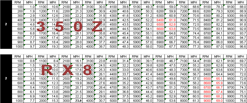

RX8-TX
12-05-2005, 12:35 AM
You have to remember 2 things:
2. The Z's redline is 6000-6500RPM (i don't remember. it's been 2 years since I drove one) and ours is 8500 (9250 comfortably). Which means horsepower considered, you're going to be going faster respectively in 2nd gear than he will and he is going to hit the top of the gear before you will and have to shift earlier.
What you should do is swap cars and you'll totally understand. The longer you keep the car in gear though, the faster you're going to go.
eehh.....Jon, c'mon! The Z's gearing is set to hit the exact same speed we do in 2nd gear....I believe! So, no...
Actually, the fact that a Z may have to shift earlier is accurate. Not because they are struggling to pick up pace but, because they get there -62mph- faster than we do. :ylsuper: You should bum a ride with Luke.
TeamRX8
12-05-2005, 02:43 AM
no, a 350Z is 7 or 8 mph less than an RX-8 on the redline in 2nd gear and it was a running start against a turbocharged RX-8, not a stock one.
RX8-TX
12-05-2005, 03:21 AM
no, a 350Z is 7 or 8 mph less than an RX-8 on the redline in 2nd gear and it was a running start against a turbocharged RX-8, not a stock one.That was pretty close actually. Depends on where the actual redlines are:
http://www.rx8club.com/attachment.php?attachmentid=64381&stc=1
BTW, thats on a track edition -only gearing info I could muster quickly. Still, not a tremendous difference.
Rotary Rasp
12-05-2005, 03:35 AM
Maybe not a big difference, but it is still about 5 - 7 mph faster dependong on how hard you push the car.
