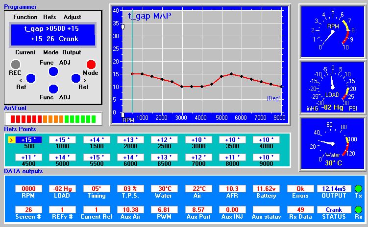

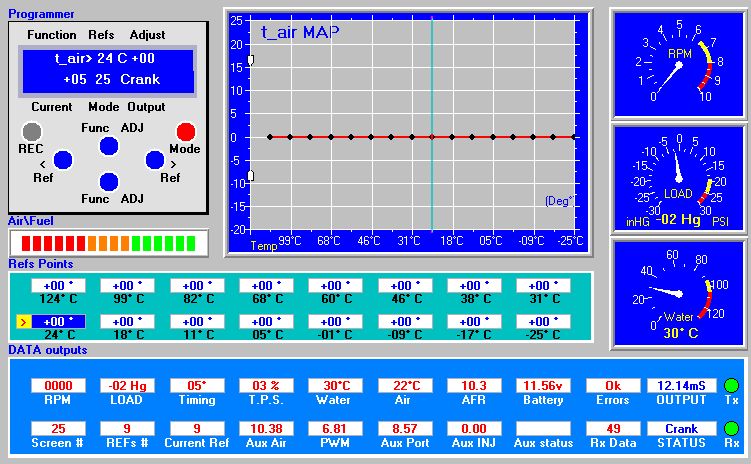

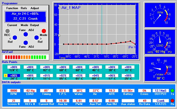

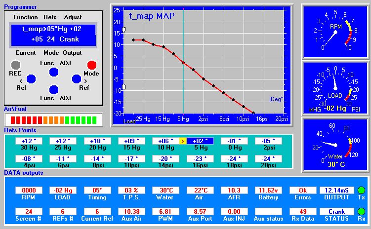

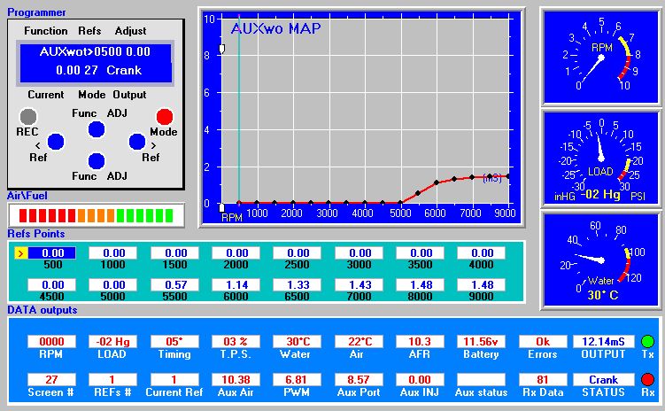

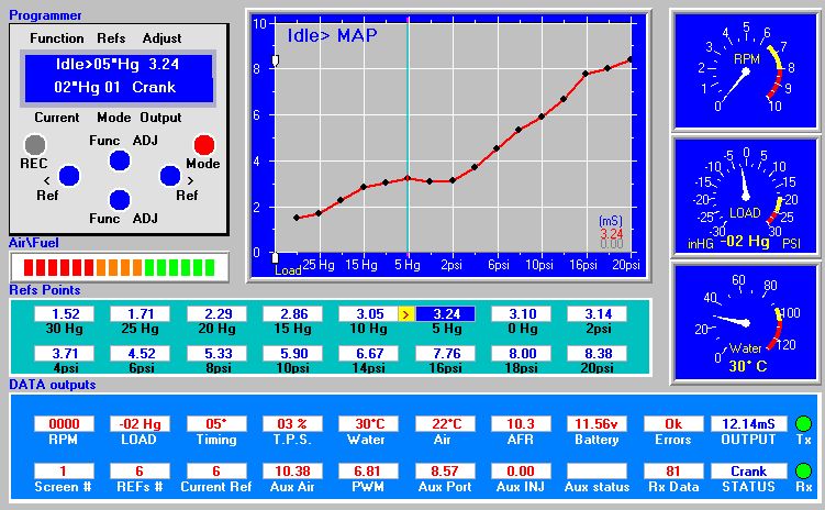

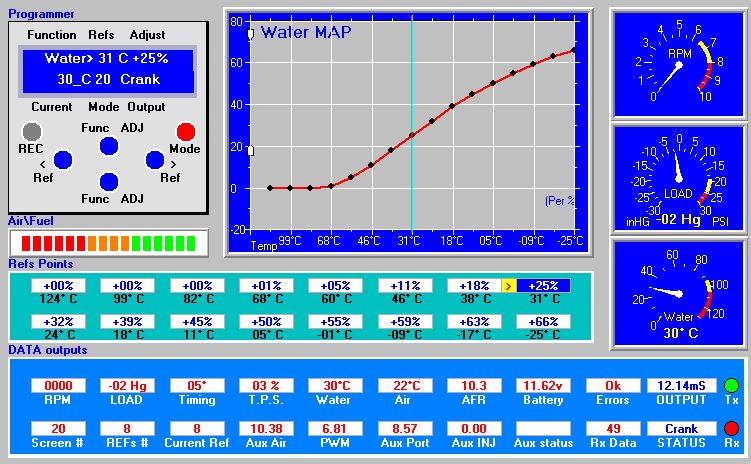

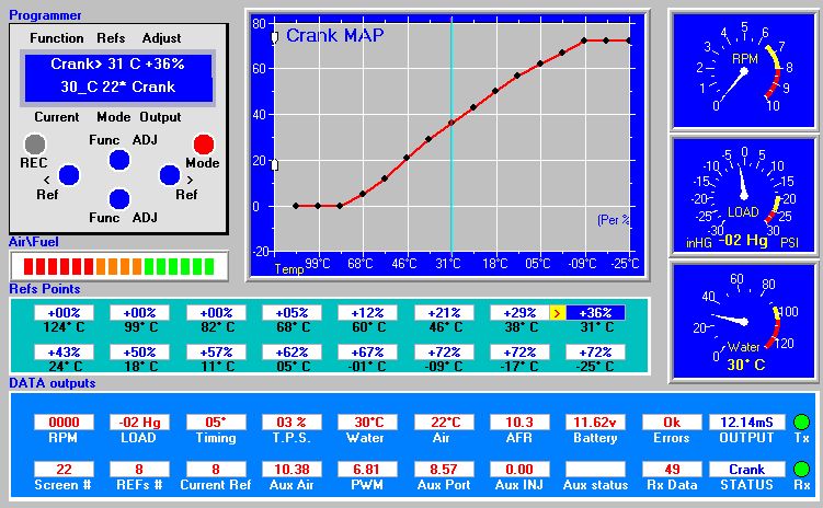

I need to ask a huge favor here. I am in need of some screen shots of the differnt maps that you have programmed and are running in your INT - X. The INT - X that i have that came with my kit came off of a totally differnt turbo setup. Now my car is having major issues starting and running. Even if i could jsut get the Cranks map, Idle map, and a few others that would relate to starting the vehicle it would be of great help. Thanks in advance guys. This will be greatly appreciated.
Old May 21, 2009 | 01:24 PM
MazdaManiac's Avatar
Joined: Oct 2003
Posts: 16,386
Likes: 28
From: Under my car
These are "general" settings. I used these on my car when I was using the Int-X several years ago.
I am certain they will NOT be correct for you in load.
But it should get you going.

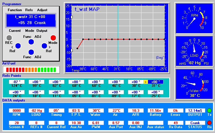

After looking through these i am curious if the timing maps will be suitiable for the car. The air fuel is easy enough to watch and figure out, but should the timing need tuning from here or would it be safe enough for a "safe tune" to be running on? Sorry for the questions just trying to figure out how "general" the maps are. Thanks
Old May 21, 2009 | 01:54 PM
Joined: Oct 2003
Posts: 16,386
Likes: 28
From: Under my car
Timing is VERY conservative on that map.
0° of advance at the torque peak and 10 PSI.
For comparison, I run about 12° of advance at the same point with the AccessPORT.

Once again i will try these tonight and see if they get me started. Would anyone else have the "Base Map" that Esmeril provides? Some screen shots of that would be nice to.
