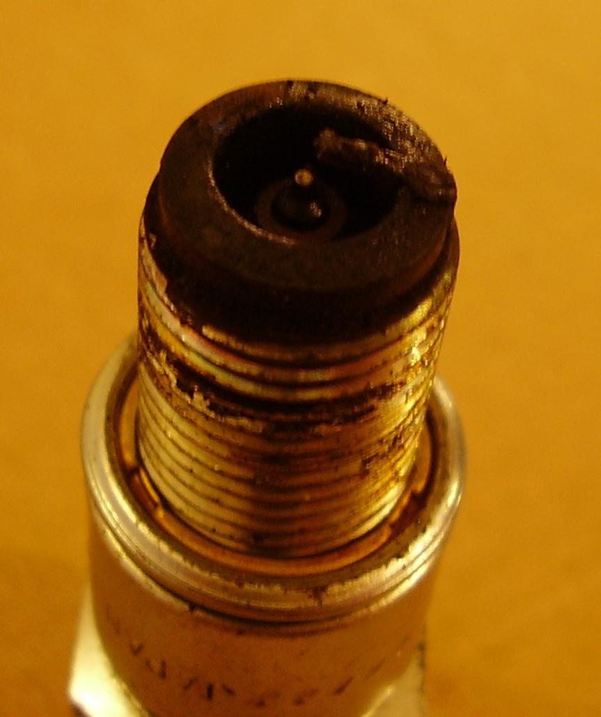

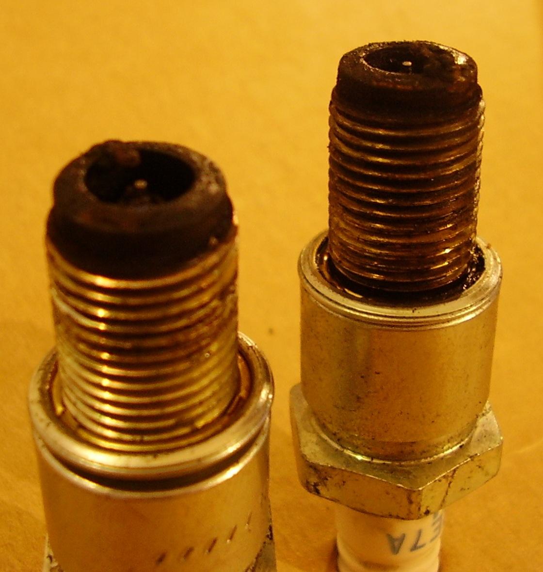

Well after many weeks of frustration with my car, visits to dealers who insisted the plugs were ok, my plugs came out today after 21,000kms.
I think the pictures speak a thousand words!

Time for a change. Lots of deposits

Those plugs look oil fouled....I'd watch your engine......

When the plugs were changed, I also got a pod filter installed. While they were doing this they found oil lining the inside of the tube that the MAF sits on and around the inside of the airbox.
At this point the guy changing the plugs mentioned that at high revs you get an air/oil mix from the engine being forced back up the air intake.
OK well both Taka and I do a lot of track days, and I have done a lot of skid pan work in the last year (4 x 1/2 day session with me and the wife both using the car). So I could see the merrit in that.
However you could also see an oil stain on the airfilter and wire mesh on the inlet!!! so my thoughts at this point are that the car MAY have swollowed a mouthfull of water on the skidpan (VERY VERY oily pan last visit).
However the oil in the intake was very VERY clean so we really dont know.
I have been told that I may want to get a catch can installed.

Ouch! That's not exactly a long service life for plugs..... it's NOT your engine
It's been our experience that OZ ( and New Zealand ) Unleaded gasoline *still has* tetra-ethyl lead added, just not anywhere near as much as the gas companies used to put in a few years back
Japanese gasoline by comparison is higher octane ( 120+ RON at the pump ) and *absolutely* Unleaded , so Rotarys don't exhibit early plug failure when run in Japanese domestic units locally; 100,000km service without any loss of performance is typical
Another *unfortunate* spinoff of adding lead to gas, is it reacts with catalyser components which use a very thin plating of platinum on internal screens; and these too can fail early
GW
Originally Posted by takahashi View Post
No chemical and rubbing.
But I am sure there is commerical product that does the same.
My mechanics did not want any rubbing or chemicals into my plug, since he fears that will damage the tip (since the gap and the heat range) and the base electrode (whatever ). I saw him putting the plug in a box of fine sand and has a compressor to blow the sand to the plug. So it just get rid of the ash deposit. Then just air blow it clean (no more sand) and take a picture like above.
I did not say anything since I don't know the pros and cons of using that but that is what he uses to clean.
Labour is $70 but it saves me $320 for the plugs. (well Mazda sells at $80 each ). Japanparts.com sells racing plugs at the same price
