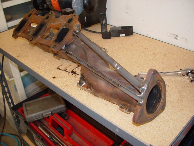

Building the turbo manifold
I know you guys like pictures. :D
I had some time today, so I started with the manifold.
First, I welded a set of supports between the inlet flange (engine side) and the outlet flange (CAT side).
This keeps the two flanges in alignment even after I cut out all of the existing manifold.
Then, I cut away the manifold parts that I don't need. The OEM manifold is stamped steel, rather than cast iron like most OEM manifolds.
It is also double-layer.
Then, I began welding small sections of pipe. I will build it up section by section just like this. I am stopping at this point until I have more time.
