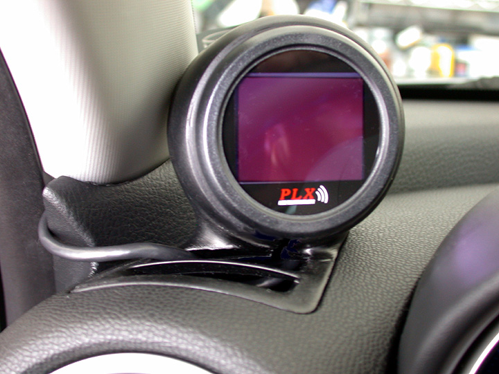

Chunbelievable - What you first need to understand is that the gauges I am running are somewhat unique I think.
Look at the picture below and focus on what the OLED display looks like(even though it's wrapped up in a bag in this picture) and the cable that runs to it. The cable at the display end is NOT detachable(it's hard wired). Now, look at the other end of the cable and notice there is about a 25 pin D type connector. It's not detachable at that end either and trust me, there are 25 very small wires in there with shielding around each one and then shielding around them all.
The size of that connector is about 1/2 inch wide and about 1 1/4 inch long, so might you be able to see what issues I might encounter given the type of gauge I wanted to use.

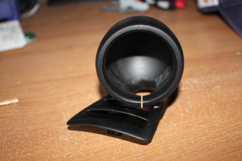

Now, for the sake of argument, here is a pic of the single pod that I used to have installed. You can see the slot that I cut with a dremel tool.
Why?, well there were two reasons.
1.) I realized that with the single pod that if I made the normal hole inside at the bottom of the pod large enough to get the connector through, it was going to be very, very close to compromising(jacking up) the exterior of the pod and I didn't want to do that.
2.) Don't forget that even then, I still had that connector that I would've had to deal with in the air vent duct and would've had to cut a hole in the duct big enough to pass the connector through. 1 1/4" long by 1/2" wide. That's a big hole!
So, for the single pod I decided to just cut a slot that would allow me to then get the gauge in there and bring the cable back out down by the vents(in the pod) and run it over to the A-pillar. Not perfect, but after a lot of thought, that was my best solution.
If you look close in this pic, you will see the slot is still there.
Now, let's jump to the dual pod.
You can see that using the two gauges of this type, I just magnified my problem.
First off, I got lucky in that for the top pod, I was actually able to get the connector through the hole into the bottom pod by removing those
long hand tightening screw things on the connector and making the hole feeding down into the bottom pod just a little bit bigger(with the dremel). The same thing was done with the lower pod(enlarging the hole) just big enough where needed to pass both connectors one at a time down through and out the bottom pod.
So, now I'm basically faced with both gauges are in the PODs, the wires are run through the appropriate holes and out the bottom, but I have two huge connectors left to deal with.
Once again I needed a way to get the cables out the front as I didn't want to deal with cutting a gaping hole in the vent duct to pass them on down. So......there is a slot cut in the dual vent gauge pod and they are run out the front sort of like the single pod setup and run over to the A-pillar. I don't think this would be an issues for most gauges as you can just drill a hole small enough in the vent duct and just pass the wires on through, but not in my application.
So...........you know there is a slot in my bottom pod of the dual pod, but it's not in the exact same place as before since I could pass the connectors through the bottom this time, the slot doesn't have to be on the pod face itself.
I wanted to make it as invisible as I could and also remove the least amount of material from the POD. Can you spot where it is in the dual pod pictures? You really cannot see it at all this time!
Do I really like having the cables showing running over the the A-pillar......no, not really................but it was simply my best option.

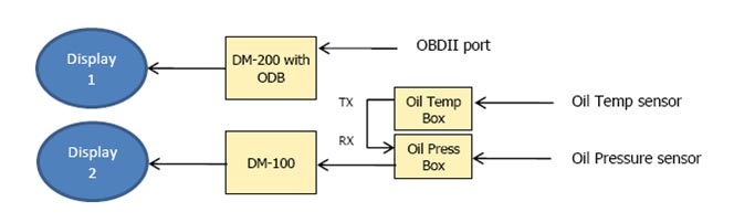

If directed at me, I have one DM-200 ODBII type, then I just have a regular DM-100(non-ODBII).
On the non-ODB one, I run the oil temp and oil pressure sensors that come from the RB oil plate adapter.
Hope that clears it up?
I do need to go verify that this is my wiring, but I will do so and let you know!
If thinking of going with the PLX devices, make sure you visit the site as they have other options now, that may be better....the Kiwi? And also realize I didn't have your basic 1-2-3 you're done install. Better look at post 50 or so!
If you didn't want the ODB at all, then you'd need one DM-100 to run the one display, and up to 32 different sensor boxes could plug into that.

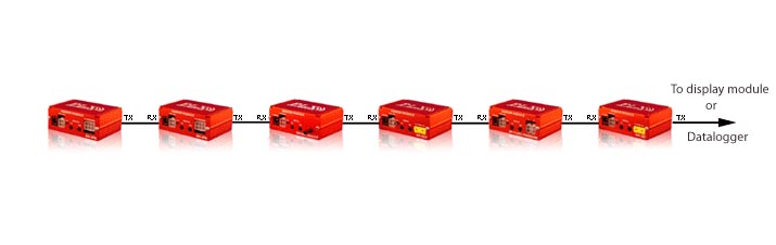

Interesting that the boxes are daisy chained. Implies there's a protocol in place separating the two signals. I'm assuming the boxes and the DM-100 are all plx?
Also not sure how much luck, or any, someone is going to have with an "active/active" dual odb2 connection. There's only so much data that can pass across the bus and have heard of numerous issues trying to get more than one thing running at once.
Yes, all boxes are plx and it's a serial bus.
I agree with your comment about dual obdII connection he's think of using and that's why I suggested he keep the refresh or reading of parameters at the longest possible setting, at least to start with.
I don't have that issue with what I'm doing.
I also updated my drawing above to more clearly define that serial bus(daisy chain).
Dave

Our car does not support all of the above list, but almost all. We also have get a select few that are not on this list!
If you look up in this thread and find the two posts I made on 12/31/2008 you will see the ones that it does.
It's all the readouts that are orange in color.
You can also go download the manuals from the PLX site and take a look yourself. They are available
I can already display 4 OBDII sensors at a time on one gauge, so if you had two ODBII boxes, that splitter cable, and two OLED displays......and set then up to show different parameters, then you could be displaying a total of 8, but you should keep in mind what Shelldude and I were discussing.
