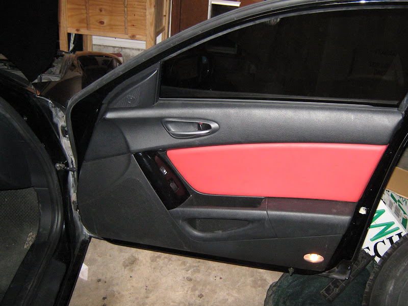

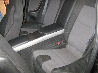

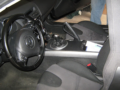

So I finished this up 95% this weekend. The only thing left is to change the steering wheel and didn't have the puller handy, so didn't knock that out right away.
Here's some pictures of the interior before I started:
Some Finished Pics:
Here's a link to all my pictures for the job, but will be adding additional info in regards to some of the minor difficulties we ran into with some of the door panels.
RX8 Interior Swap
Still Uploading all pics....working on finished and then a little bit of walk thru info to come after that.

Looking to buy an 8 soon, there is one available locally 20k miles but cloth, and I would definitely want the leather. I noticed from pictures 2, to 3 in the OP, some seat heater switches appeared in the center console. Did you have to take these out of another RX interior as well, or were they addons somehow?
Any info on that would be great
