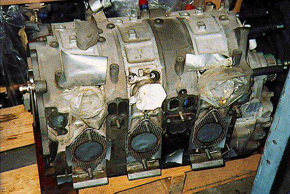

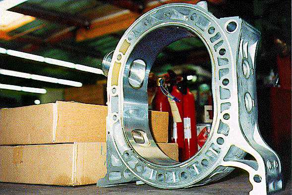

Have you not heard of a PORIPHRIAL PORT ?
This is when the side intake ports are blocked off and an intake port (65mm ID) is created directly in the rotor housing. Racing Beat did this with their Bonneville Record try. I believe it was a Third gen. RX-7 with a 900HP Periphrial Port 20B.
I had an NA 13B Periphrial Port that had a little under 300hp.
Just think Racing Beat had three turbos on their engine.
Here is a pic of the rotor housing and a pic of RB's engine.
Just think how much fuel and air you could push through a pair of 65mm intake ports. Is your brain spinning now.
Note the intake and exhaust ports in the rotor housing, no side ports.
ID:	83692   Click image for larger version

It's "peripheral"
