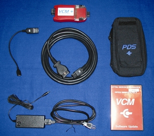

Funny this should appear!I am just sitting here reading the Training manual for the Mazda Modular Diagnostic System(M-MDS).There are 2diagnostic systems within M-MDS----one lap-top based(IDS) and one on a PDA.The system has a Vehicle Communication Module(VCM) which is a black box with cable to the in car data link connector and USB to the lap top or PDA.
My brain hurts!
My brain hurts!
Actually, its red.
Then again, the "black boxes" in aircraft are yellow and red.

pic
