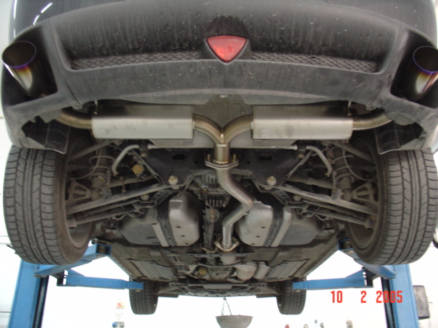

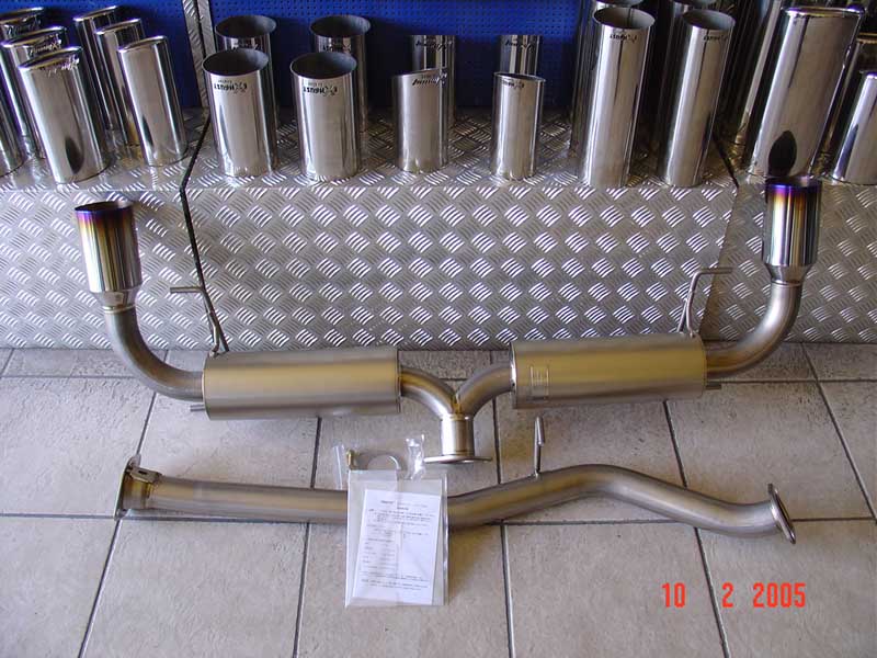

Cool TRUST Full Titanium Composite Cat-Back
OK, I know there are numerous exhaust threads, but I just bought this little piece of art for my car, and since it's a fairly new product (it was releashed only a couple of months ago) I thought I could share it with you guys.
It is quite loud and extremely light. I didn't have the chance to weight the two parts. Another friend of mine got it too and told me it is 4.8-5kg or about 10.5-11lbs. Judging from the fact that it was so easy to carry and pretty small in size, I guess he is right. Performance gain is noticable, but I can never be sure if I don't see real numbers. I hope I can visit the dyno again soon (I already did a few runs a while back, so I'll know what the difference will be). Now, if you wonder how it looks...
Oh, and I forgot to say, I tried to pick up the stock exhaust afterwards and it felt unbelievably heavy :D

Isn't this the same as a Greddy?

dam those cans are small! Shit looks light...

Not to often "small cans" are a good thing.:D
Anyway, looks like a nice exhaust. Sound clip after install?

I paid about 1350-1400Euros for it. Not sure because it came with other things. It is a great price, if you consider that car parts over here are very expensive. Local dealers sell it for 1700-1800Euros... The cans are very small indeed.
It is the Greddy exhaust, only made from titanium...
I have seen the stock exhaust's weight many times in this forum, its about 17.5kg or 38.6lbs:o

I have seen JIC Full Titanium over here supposed to only weigh 9 lbs. but the cheapest I have seen is $1300-$1350. You are correct the RX8 from the catback is approximately 38 lbs. I know Amuse has a full titanium unit but it supposedly weight around 18 lbs. I have heard of titanium exhausts on other car craking at the joints, and this is not the type of material that you can take to your local muffler shop. That Trust unit looks pretty trick.
In general, cyclic stresses on Ti alloys causes them to harden and become more susceptible to fracture, notably at points where flaws are introduced (eg welds at joints/flanges). The same is true for most metals, but Ti shows a particular susceptibility. The Russians used to use alot of titanium in their submarine hulls, and they could go really deep......once (became depth limited due to cracking after that).

Fanman: you are right, titanium exhaust is not an easy thing to fix... but I couldn't resist. Like I said, its a great product. Hope I won't get any problems in the future:o

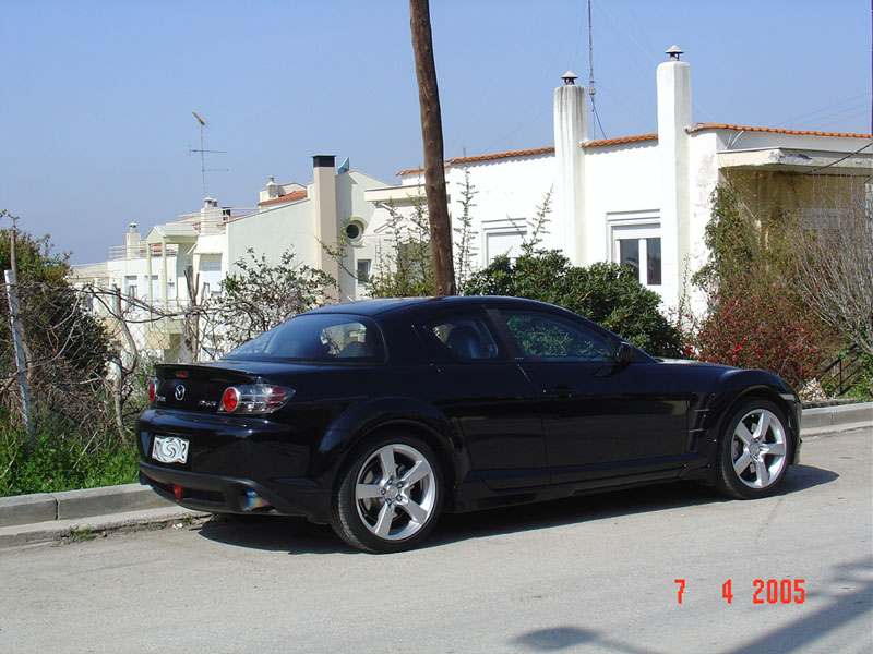

more pics please Rotormaniac..

only pic I have now is this...
I have another one at the dyno shooting two huge flames:o but I can't find it now...

what's the diameter of the piping?

It's 65mm, but I'm not sure... same as the Greddy SP2
its the same company/exhaust basically, it says "TRUST" on the tip and it has no lip...
it comes in stainless steel too, if you don't wanna pay for the titanioum...
