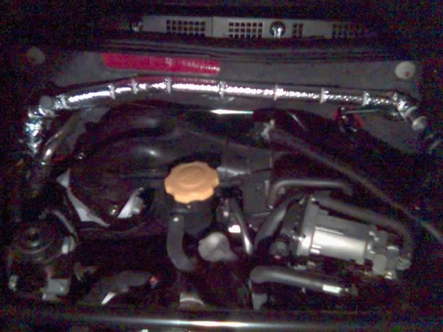

This weekend I took a heat reflective cloth and wrapped the AC line under the hood that is exposed, I put small cable ties approx. every 2-3 inches. and cut a small square out for the little valve on the line. Today I drove to work and the AC was the coldest it has ever been and remained freezing cold for my 25 minute drive to work. Easy mod and takes about 15 minutes, it even adds 100 HP!!!!! J/K :D :D :D

Attached is a photo of what I did, it is a strip of heat cloth, I fastened it with small clear cable ties approx 2-3 inches apart. This method you do not need to remove the tubing just wrap around it.
Sorry for the photo it is taken with a camera phone.

Thanks for the pic. Looks like a winner to me. Thanks for taking the time to tell us about it.
