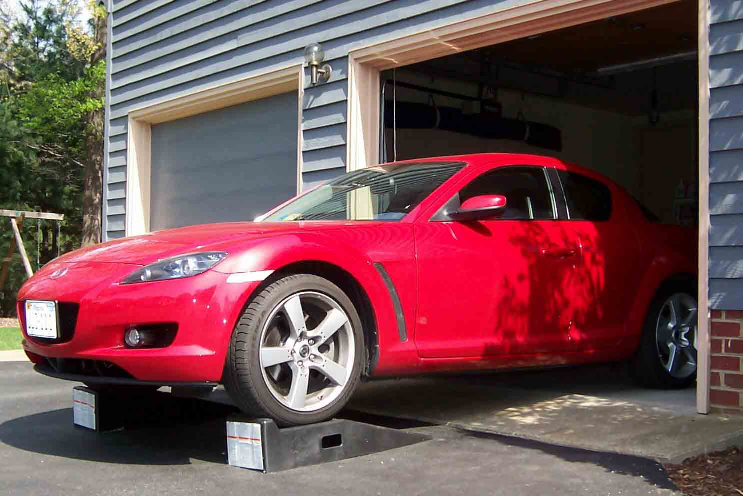

To level the car for installing the MT oil I did the following:
There is a mild incline (15-20 degree) in my parking pad going up to my garage. I did the following:
1. Backed the car into the garage
2. Placed a pair of Rhinoramps down the incline in front of the car so the top if the Rhinoramp was level with the garage floor.
3. Drove the car out of the garage and onto the Rhinoramps resulting in the car with its front wheels on the Rhinoramps and rear wheels in the garage.
It took 4 or 5 tries to position the Rhinoramps at the right spot on the incline so their top was just level with the garage floor. To confirm the car was level, I first used a carpenter's level on the top part of the door sill with all 4 wheels in the garage, then checked to confirm the same reading with 2 wheels on the Rhinoramps.
This results in plenty of room to work on the Tranny from underneath the car. I used this technique when putting RedLine MTL in my Miata (which is even lower to the ground) years ago. Looks pretty goofy though!
You know it's a bitch finding any portion of the RX-8 that is "level" when the car is on level pavement, too many styling lines and curves.

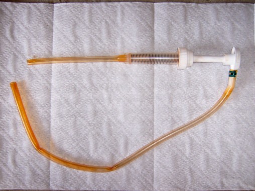

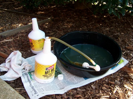

With the car raised up, I used an inexpensive pump (first picture) to install the oil in the transmission (second picture). The same pump can then used to move the old oil into the empty bottles (third picture) for recycling.
The pump can be purchased at most auto parts stores. My local NAPA Auto Parts store has two types of these pumps in the $5-$6 range. You will find them in the Gear Oil section.

I would have to say that fluid changes without raising the body a little would not be possible.
An oil change, where you use a shallow pan and an extension socket is do-able, but not tranny or diff.
If you want a really stable, level and safe lift, you should get two ramps, a jack and two jackstands.
Put the ramps behind, and put a little wood between the wheels and the ramp, to give the tires a 'head start'. The rear wheel drive will scoot the wheels up, then leave it in gear, handbrake on.
Ain't going nowhere. Then jack the front at the frame rail just ahead of the motor, jack it way up until it's level, front to back, then lower it gently onto your two jackstands.
Solid as a rock, safe and lots of room to torque stuff......enjoy!
Well, thanks for taking the time to reply, and for the advice on safe lifting.
Looks like my Sears shopping list is going to be a little longer, but hey, can you have too many tools? I didn't think so!
