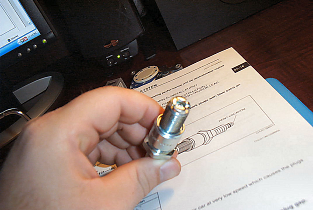

Here's a little DIY on how to replace your own spark plugs. Some people have reported Mazda dealers charging $300 for this ( )! For anyone wondering why I changed them, they were extremely fouled from the first 10,000 miles of driving (before L and M).
*EDITED TO ADD- Remove the driver's side wheel before starting*

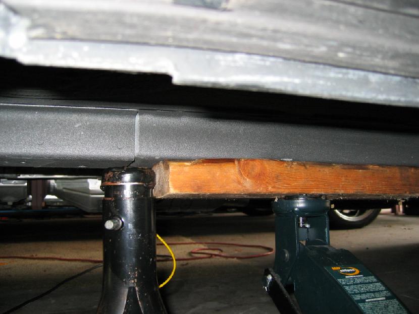

#1 - Jack the car using a good hydraulic jack, placing a piece of wood between the jack and your frame rail. This will prevent you from denting the underside of your car. ALWAYS PLACE A JACK STAND UNDER THE CAR. THIS COULD SAVE YOUR LIFE!

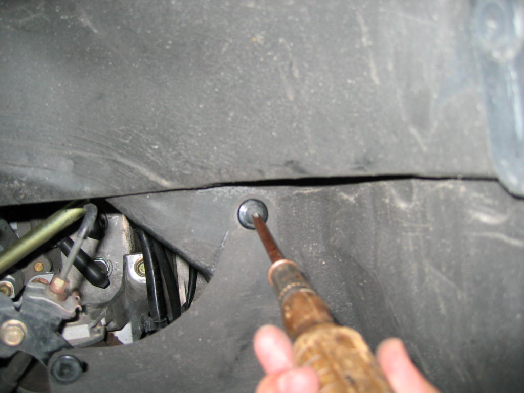

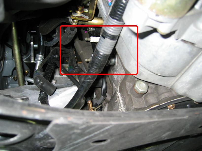

# 2 - From underneath the car, you have a clear reach at the rear plugs. I recommend breaking them loose with the wrench, but then removing them by hand. Not only do you avoid banging your knuckles on everything, but it goes faster.

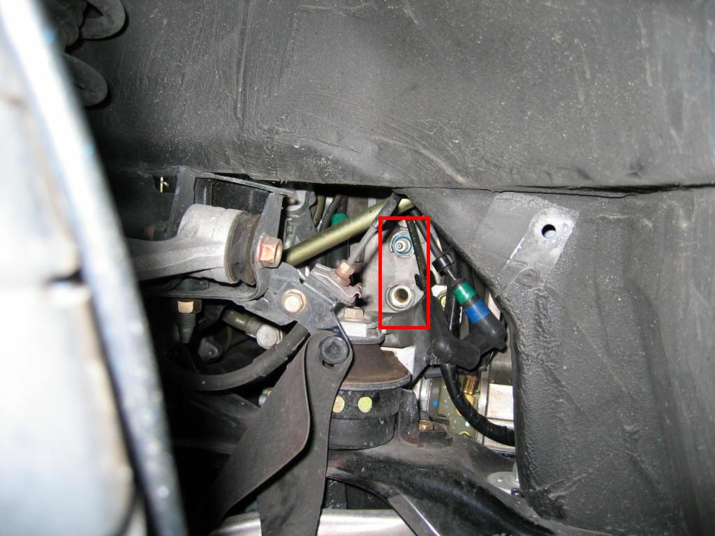

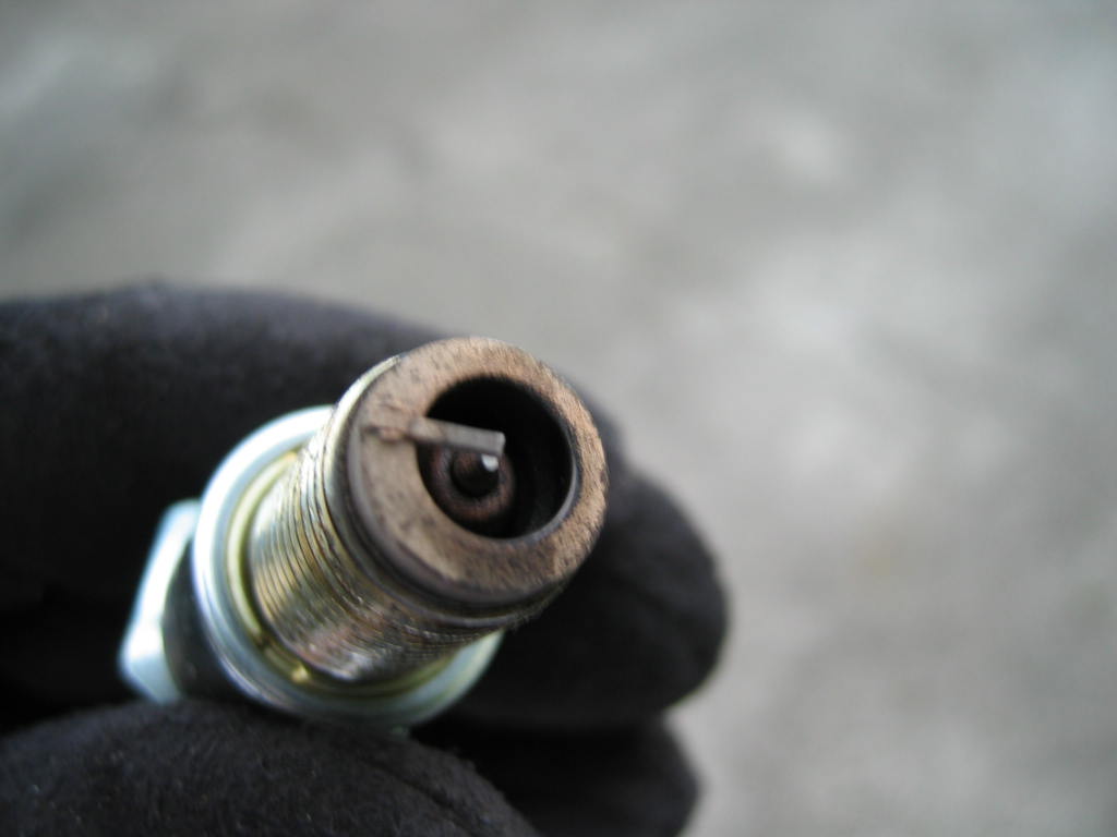

Once removed, your plugs will look something like this. Clean them in your preferred method.

For the front rotor, the plugs are tough to reach. Next time, I will remove the driver's side wheel, but since I didn't have my lug key with me, I still reached them by turning the wheels all the way to the right. Behind the wheel, remove the upper fastener on the rubber splash "thingy". (Oooohh....Technical terms! :D ) This is NOT a screw, but one of those that only requires a quarter turn to release it, similar to the clips on your wheel well liner. Once it pops out, gently pop out the washer by sliding a flat head screwdriver under it and twisting gently. Did I say gently? Seriously people, these things beak easy.
If you've got skinny arms, you CAN use this method, but as I said: Take the wheel off.

The front plugs are now visible.

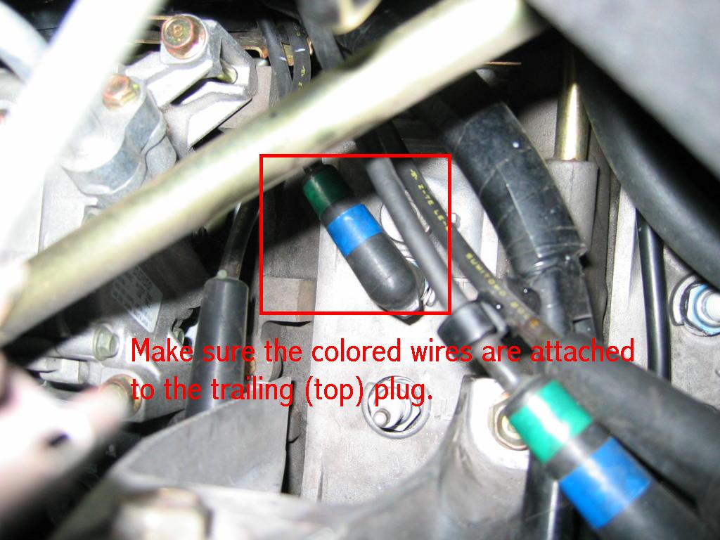

When reinstalling the plugs, be sure to apply a light coat of anti-seize to the threads.
Each plug is marked with a T or an L, which indicates leading or trailing. It is VERY important they are reinstalled correctly. Double check this, and note the T and L cast into the side of the motor beside each hole. Match these up.
Also, you did notice that the trailing plug wires are marked with green and blue tape, right? If not, make sure upon reinstallation that you attach them correctly.

I was not able to thoroughly clean the plugs.
I removed the carbon on the top surfaces, but without a sandlblaster, I couldn't get down to the bulk of the gunk that was deep inside.
It DID make a noticeable difference in throttle response and bottom end. The car pulls smoother, and the loss of power at 7K is gone. However.... The knock is still there. I think new plugs would do the trick, because it is lessened after the partial cleaning of the plugs. Mazda needs to step up and replace plugs on cars with several thousand miles on them before L was released. I doubt they will, though.
