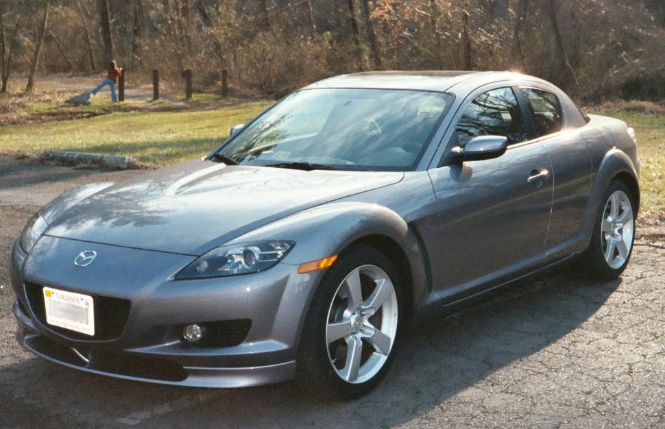

For examples sake, this is the front fascia. I used to have my license plate and bracket as pictured [bugs bunny position, if you will]. As mentioned by someone else on this forum, "In the enduro race on Best Motoring International...there was a rather LARGE difference in water temps on the rx8 when they added the front license plate to the car. Of all the car's (with front plates added), the Evo had the least change in temps, due to the side mount (didn't block anything).
They had two sessions, one without plates, and one with plates. For those interested, check torrentspy and search for best motoring, and download the enduro race."
With this in mind, I've got to add that only the bottom 1/2 of that black matte bumper insert is open to airflow. Thus, if 5" ^2 of license plate is covering open inlets, it goes to show that minute changes to the front fascia of your car can have dynamic results.
The point I'm trying to make is, if you've got too little, bigger is better, at least to a point - and I wanted to reinforce that even the smallest of changes can have drastic effects. I'm sure that the airflow versus heat exchange levels off sharply at a point (all the way to bumperless) but I can think of several examples where car designers/engineers have dropped the ball. I don't pretend to be as audacious to say I'm smarter than someone who does it for a living, please don't quote me as saying that.
The 1/4 surface thing I mentioned above intrigues me. Reference the size of these coolers to the size of the inlet in the first post:

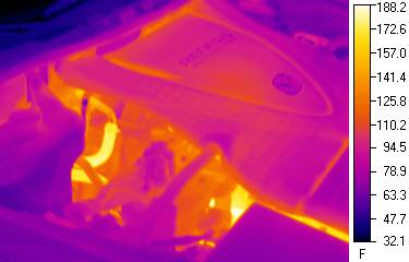

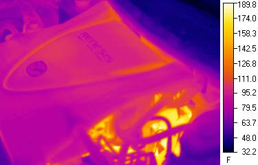

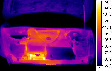

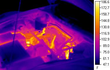

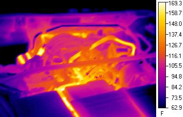

Here are, in my mind, some of the most genuinely important pictures that you can take of your car: *Note that these temperatures are relative*
No heat from the A/C line, that's BS. No heat from the throttle body that's BS. Go drive for 20 minutes and then open the hood and touch them and I'd have 3rd degree burns.
Engine pics with cover on
Engine pics without cover
The money shot
It can be clearly seen that the fender vents are NOT functional. One might want to find a way to duct hot air into the empty fender to allow for lower underhood temperatures. Unfortunately, upon further investigation:
The bridge from the engine to the fender is smaller than a Reese's cup. I assume no one is willing to mess with the structural rigidity of the car, or void their warranty. I see 2 options, the ghetto, and the elegant.

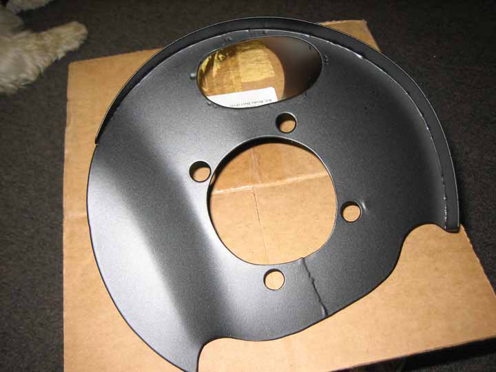

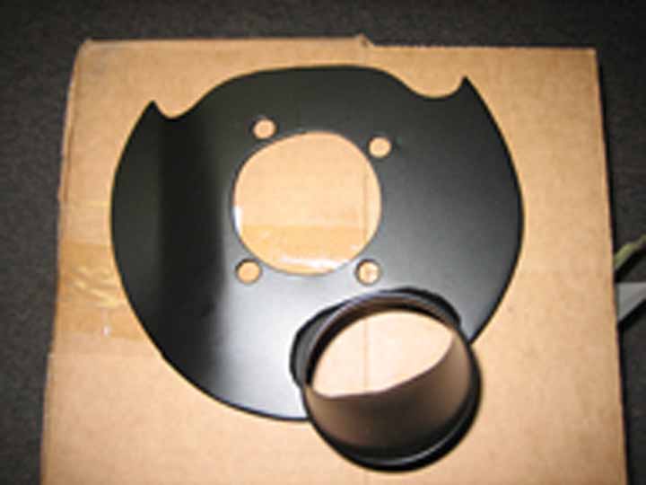

Finally, something I'm throwing in at the last second, brake ducting the non-ghetto way. I've never seen a comparable product for the 8, but here are some Forge brake cooling for Evo (without brake ducts).
Originally Posted by ? Jay Goldfarb perhaps?
The fact is, unless you are ducting air directly to the center of the rotor, allowing it to flow out through the vanes, your cooling effect and performance enhancement is somewhere between diddly and squat.
This kind of negates the dryer hose method, although someone here at the rx8club cited 150* drops (using a pyrometer, perhaps Polak) using the ghetto cut fender/add gutter method.
Thus, backing plates (dust shields) are a good option. Speedsource will sell them to you.
They're pricey.
Someone mentioned the quality of the Speedsource/Mazdaspeed plates on the other forum, when I posted them up for consideration:
Originally Posted by CC
so why is whoever makes those backing plates with dutcing too lazy to unbolt them the proper way rather than cut it. Upon re-welding unless he's following very specific welding techniques that whole back plate can heat deform.
I'm not sure if this is valid or not.
I think we may be looking at different areas. In the photo below is that same part, the red box indicates a cut and re-welded area, which has no matching cut and re-weld area above it that i can see. In addition to the fact that i'm sure whoever produces these parts doesn't make enough to afford a 100k+ dollar press to stamp out these things new, so they look like they have been unbolted and cut, as indicated by the red box, then the green box appears to be the deformation of the metal (though flattened back out as best as the builder could manage) from having cut and pried the plate off, and then the purple circles look to be spot welds for that tubing which looks to essentially be rolled over sheet steel.
That part will work for its intended purpose, just not optimally, i'm guessing whoever makes them has a hard time getting to a bolt or nut on the hub that plate is affixed too, which makes removing the hub for a proper backing plate uninstallation difficult. Thus they cut it for removal, and now having full access to whatever the source of problem was, can re-assemble in the proper order after welding the plate back up.
Honestly though, if built on a case by case basis, a part like that could be fairly easy to fabricated on a car, or just don't be lazy and remove the plate the right way. Either way, simple enough to build, just need the car on a lift and go.
We pay what, $300 for plates? My only argument is that they seem to work pretty damn well for Speedsource.
With this said, please add what you can, to this Noob's guide for cooling, I suppose. I'm sure I missed about 40 relevant topics, like radiators, and I would be delighted if ya'll let me know. My only request is that we keep hearsay and OT chatter to a minimum and provide DATA when you can.

Nice thermal pictures.
What I have to add here is just engineering pragmatism. I'm an electronics engineer by trade and I care about temperature and heatflow in the products I design.
The advice I have to offer is this:
Consider whether it matters if a location gets hot before you go trying to cool it off. Sometimes in doing this you rob the airflow from another needed area.
It obviously matters on the oil coolers, and on the AC if you are trying to stay cool in a hot climate.
It may not matter on the brakes. The brakes in the RX8 are freaking huge and really good compared to almost any other car. If you are autocrossing your car, you have time in between runs to cool the brakes and the low airspeed of the car doesn't put much air flow against the brake rotors. The extra unsprung weight of ducts will not shave any time off your lap.
However, in road racing it may make some difference if you are seeing brake fade.
The difference in brake pad life between a 50 degree temperature difference is probably pretty small.
I wouldn't needlessly cool things.
Finally, when you see hot spots right next to cool spot in your thermal images, that's not necessarily bad. It probably means that you are getting enough air flow that the heat is getting out of the area. Big blobs are probably bad.

ok so now you know HOW the car cooling works, and with some quick searches you can find average temps (oil, water etc)
you need to figure out WHAT temps you want to lower/manage. ie do you wanna lower oil temps? water temps? both?
once you know that, its gonna be really simple to implement it.
seems like, looking at the thermal pics, that theres nowhere for the air to go after its gone thru the radiators
"The fact is, unless you are ducting air directly to the center of the rotor, allowing it to flow out through the vanes, your cooling effect and performance enhancement is somewhere between diddly and squat."
Couple comments...
- Why leave out the "ghetto" method as you call it? It is a useful track cooling aid.
- The "ghetto" cut fender/add gutter ducting I use works to the extend it lowers temps, but it's also 100% invisible, so .... so who cares and how is it "ghetto"... because it cost less than $20 complete both sides in just a short me? Ok by me if so.
- I did the original DIY http://www.rx8club.com/showthread.ph...ght=brake+duct on the "ghetto" method - I don't remember if i said 150 degrees, but if 150 degrees is between diddly and squat, so be it. I don't have the luxury of a gutted chassis to route hoses that SpeedSource has.
- The EVO you show with the beautiful welded duct work (but no shield) has no other passive air flow cooling - so it looks essential for any cooling at all with that BB setup. Of course the fancy duct brings it directly to the center of the 2 piece rotor, which is nice
On the other hand, our OEM shields have useful built-in air gathering vane, that does a fairly decent job at bringing cool air onto the rotor surface of a solid rotor or to the rotor/center of a 2-piece. The DIY simply increases the flow to that air gathering area somewhat at speed.
Except for this missing info , a nice compilation of thread quotes and pics BTW. Great idea

Couple comments...
I've just been critiqued by others for "cutting up my car" doing the same thing before, I don't mean any disrespect. If I didn't think it was a good idea, I wouldn't have included it.
Wanna get together with someone with a thermographic camera to see if the plastic in the ducts is as hot as the oil coolers/brakes? That would confirm effectiveness at least to me.
- I did the original DIY http://www.rx8club.com/showthread.ph...ght=brake+duct on the "ghetto" method - I don't remember if i said 150 degrees, but if 150 degrees is between diddly and squat, so be it. I don't have the luxury of a gutted chassis to route hoses that SpeedSource has.[/qujote]
150* is progress in the right direction, but I can't qualify it. I'm sure that someone on this website can, though.
- The EVO you show with the beautiful welded duct work (but no shield) has no other passive air flow cooling - so it looks essential for any cooling at all with that BB setup. Of course the fancy duct brings it directly to the center of the 2 piece rotor, which is nice[/quote]
Normally there would be a hose connected to the duct on the brake, but it was removed for pictures
