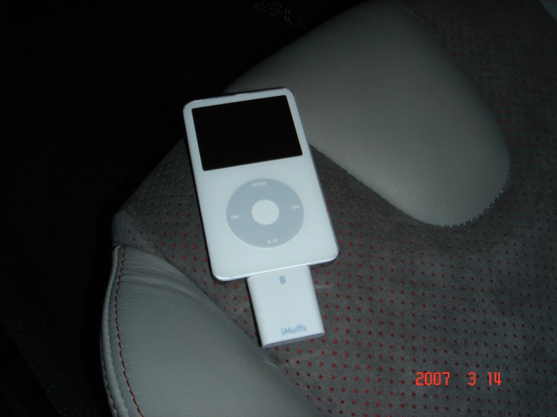

* iPod with stereo dongle (iMuffs MA110 Dock Adapter, http://www.wi-gear.com/products/imuffs/ma110.php)

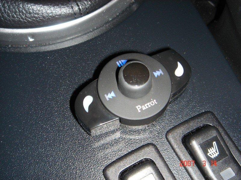

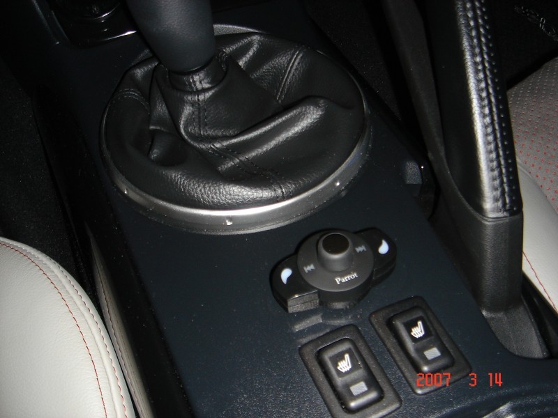

The Parrot MK6000 controller was mounted on the center console, just in front of the seat-heater switches, for easy reach. The Parrot MK6000 dual-mic was installed just above the rear-view mirror, with its cable routed under the headliner, down the A-pillar, and into the area behind the glove box, where the Parrot and QC boxes are located. See sonicblue6's DIY for the installation of the Parrot CK3000 for more details, as the basic installation for the MK6000 is pretty much the same.

Since the Bluetooth stereo dongle on my iPod dock adapter supports the AVRCP profile, the MK6000 controller provides the basic Previous, Next, Pause/Stop controls. You can also use the iPod to control play-back, but volume is controlled with the volume knob on the MK6000 controller. In practice, it's necessary to use the iPod anyway to select the desired album/play-list/authors/etc. So, unless you want to repeatedly listen to a particular set of songs, I would keep the iPod in reach instead of stuffed in a bag in the backseat or in the trunk. MP3 audio is CD quality and is stereo to all the speakers; I can't tell the difference between MP3s streaming from the iPod and the CDs that I ripped them off of (high quality MP3, of course).

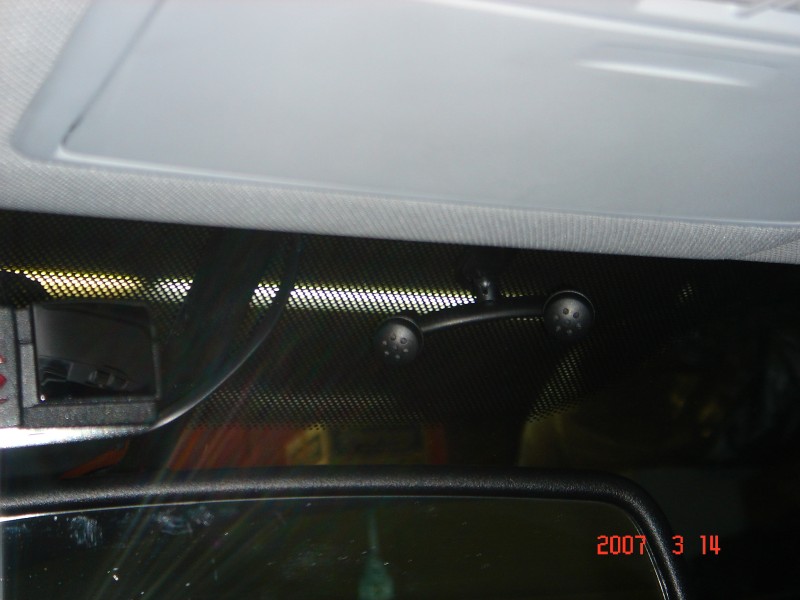

The hands-free side of the MK6000 works for the most part. For voice recognition to function correctly, the setup requires you to record MK6000 "keywords" such as TELEPHONE, HANG-UP, WORK, HOME, OTHER, etc. Most of these are to access the numbers of the MK6000's phone book which is synchronized with that of the cell phone's, if that capability is supported by the cell phone. However, using the MK6000's phone book is cumbersome at best since you have to use the volume knob to select the name/number you wish to call. In addition, multiple entries are created with the same name for a person with work, home, pager, etc. numbers. So a person with five contact numbers will result in five entries in the MK6000 phone book all with the same name --- which makes it hard to dial the correct number.
Saying, TELEPHONE at highway speeds will not work for me, but will work when cabin noise is relatively low, for example, waiting at traffic signals. HANG-UP always works, and as expected will hang up the phone conversation, as will pressing the MK6000's red controller button. Pressing the green controller button is equivalent to using the TELEPHONE "keyword" to start a phone call. It mutes the HU devices or pauses the iPod and, with my RAZR, activates the phone's voice recognition. From that point on, the phone's voice recognition works flawlessly.

* Since the iPod's dock connector is taken up by the stereo adapter, you are running the iPod on the batteries and will have to recharge more frequently. This is more of an issue with the iPod/Adapter setup, though, and not with the MK6000.

* MK6000 does not turn off with ignition-off, the majority of the time. You have to press the volume knob on the MK6000 controller to switch it off. The "Key-in-ignition" chime sounds to alert you to this situation, though. This behavior may be a related to the QC Bose-RX8 harness, as the MK6000 in my other car (non-Bose) shuts off when you turn off the ignition. Edit: This has been fixed --- see post #7
* Resuming iPod playback is more reliable if you pause the iPod before pressing the green button on the MK6000 controller to start a phone call. Then you need to press START on the controller or iPod to resume the music after the phone call.
