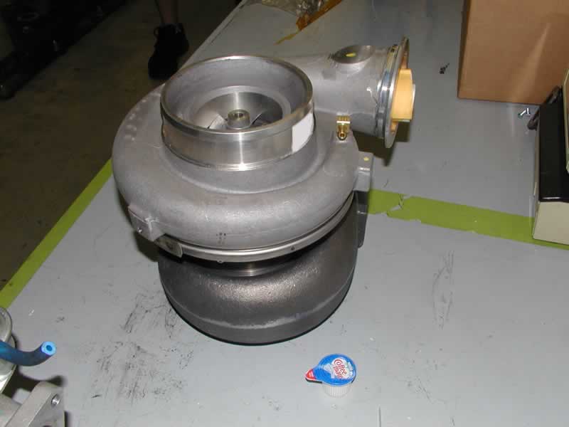

Originally Posted by stickmantijuana View Post
how much do these weigh? i suppose the hot side is all steel? i could ship him a back brace
It's heavy, this turbo start makes boost at 2800 RPM on 20b, on my case we,ve modified this turbo to a 88mm. Inducer and 1.44 exhaust housing and it's start makes boost at 3500 RPM, Good Choice Stick!.

Hi Stick!!!

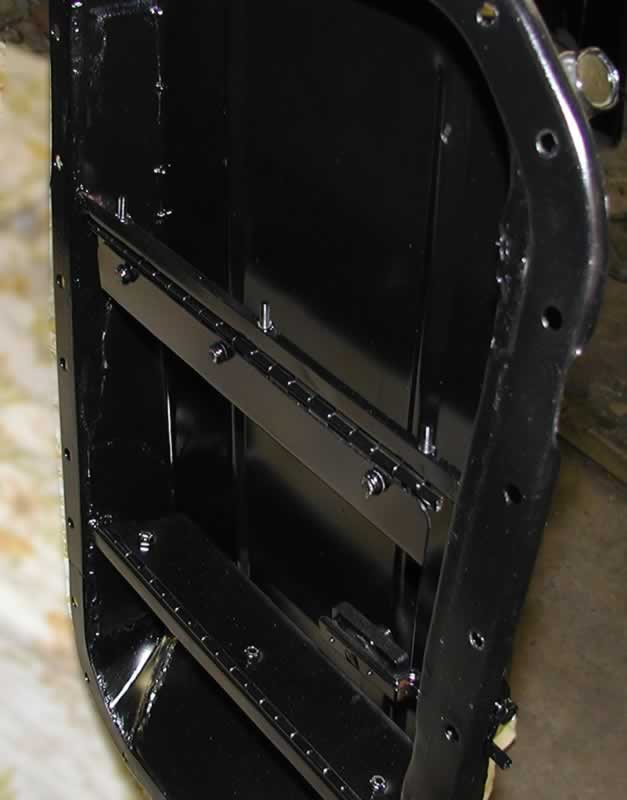

custom oil pan ala scott looks better than oem!!
the cross members you see are hinged baffles that'll minimize oil slushing under high braking and acceleration. rear will swing shut during acceleration; front will swing shut during braking.

Old 06-07-2007, 12:52 AM   #134
slavearm
Boost Junkie
Location: Orange County, CA
Posts: 724
Send a message via AIM to slavearm Send a message via Yahoo to slavearm
Looks great. BTW... I hope this means your car is getting close to being done. Sheesh... man if I would have known I was behind your crazy butt, I might have had to send some "friends" to misplace your car until mine was done. LOL.

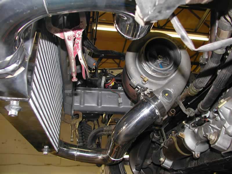

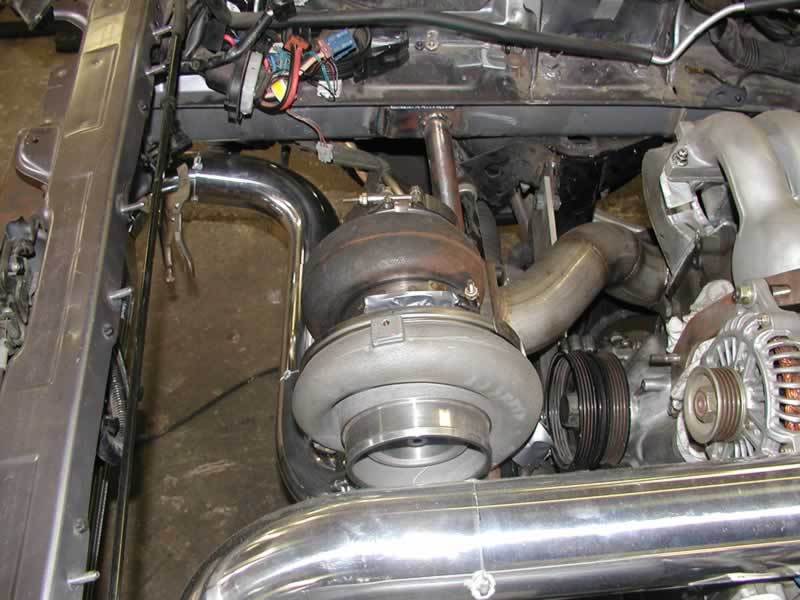

couple progress photos. things should move quite quickly now.

son of a ----!!! Dude---damn. One bad ass power pant being born. Great oil pan design. One question please and I am learning here--what about the baffling for the lateral G's you may be pulling on the road track?
what kind of oil coolers will you be running? DId you say traction control system? Not the oem one right?
