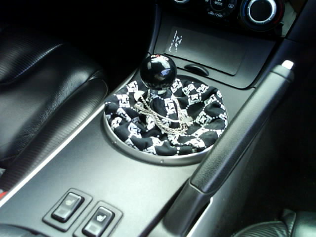

PICS or it never happened lol, na jk cool idea dude...im excited to see it

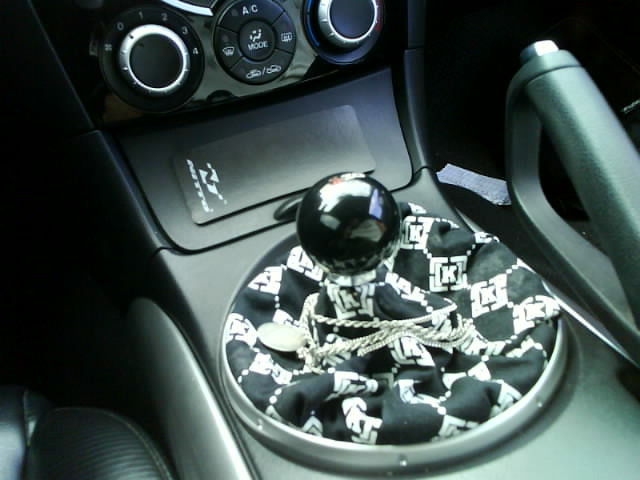

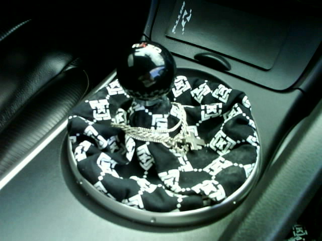

ok so these shhould be the pics.. haha you can can see my Razo shift knob,nitto phone holder thing, and my cool saint christopher and lil cross thing i have around my shifter too.
hope you like.

thakns glad you guys like... i know that the pattern isnt the best matchignf ro the car, but hey i had to try it with something.. haha. its only took like three or four trys to get the fitment right..
