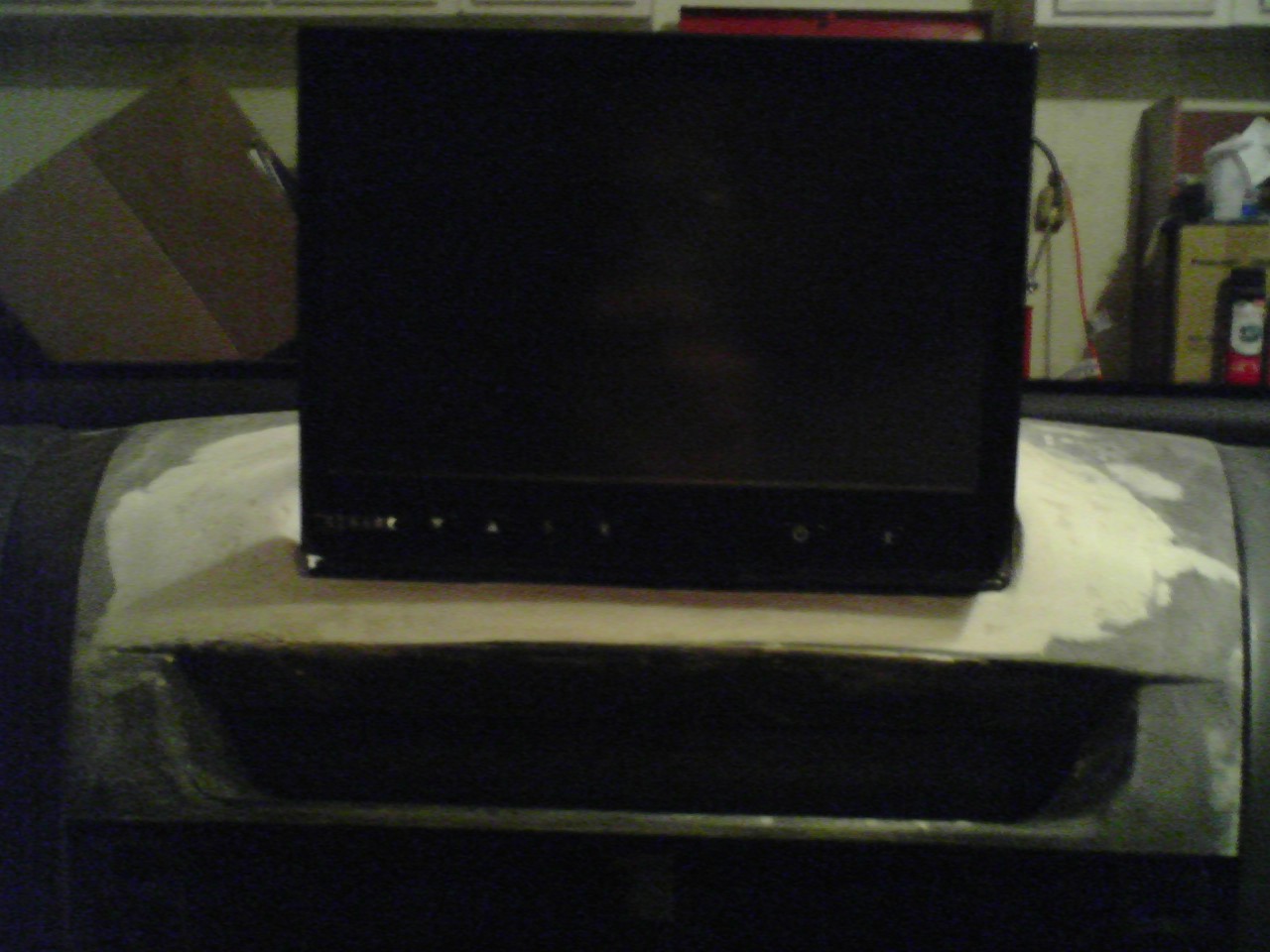

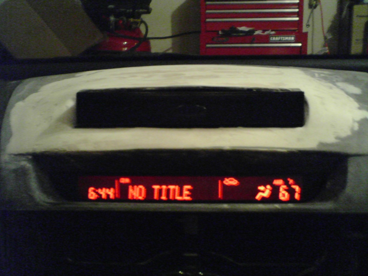

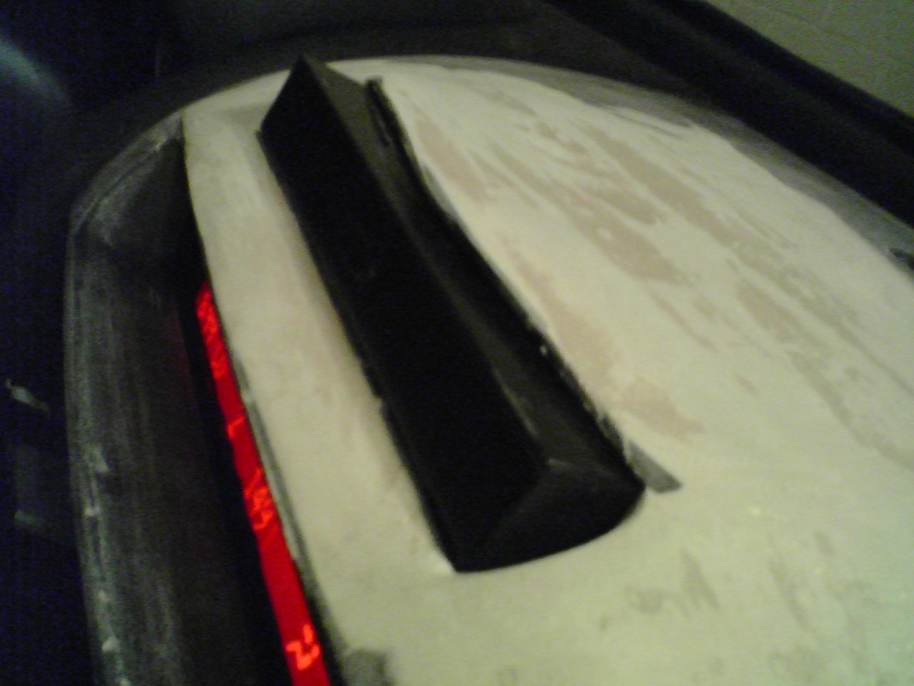

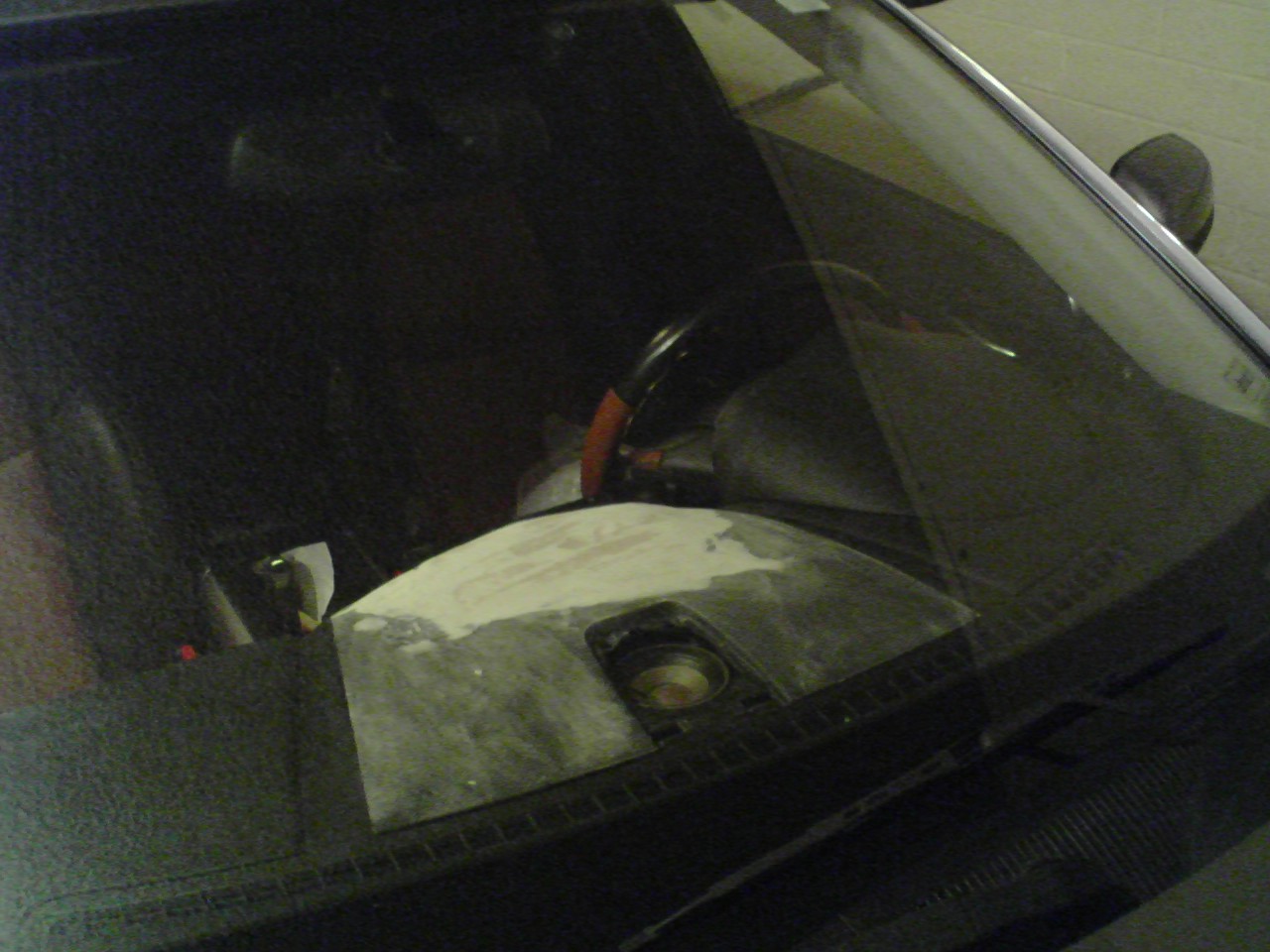

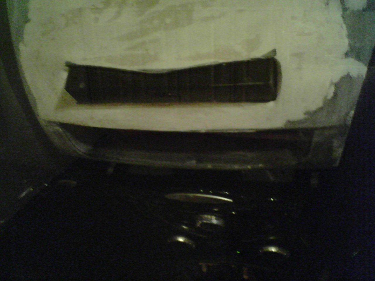

Here's the beginings of my second dash. I decided to try building this one myself to see if I could do better. So far so good
edit - Please excuse the pic quality I only had access to my camera phone today.
Attached Thumbnails My CarPC / Carputer-pic0017.jpg   My CarPC / Carputer-pic0019.jpg   My CarPC / Carputer-pic0020.jpg   My CarPC / Carputer-pic0022.jpg   My CarPC / Carputer-pic0023.jpg

one more -
Attached Thumbnails My CarPC / Carputer-pic0025.jpg
